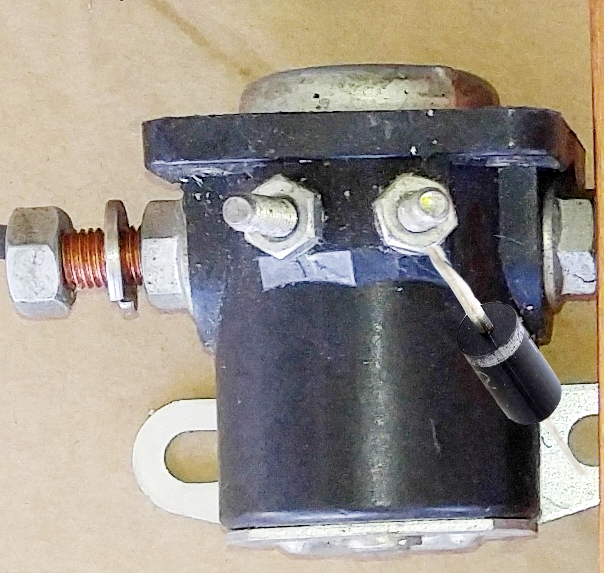

Does Anyone Recognize This Starter Solenoid???
PostPosted: Thu Oct 10, 2019 5:35 am    Post subject: Does Anyone Recognize This Starter Solenoid??? Reply with quote
[img]cid:7.1.0.9.0.20191010082956.061373d0(at)aeroelectric.com.0[/img]
If you examine the housing at the base of the
terminals, I think you will see a letter "I"
on the left one, and I forget what's usually
on the right one . . . an "S" perhaps?
In any case, the I terminal is used for your
'stuck starter' light (optional) and the
starter push button delivers power to the right
terminal. The diode (1N540X series) installs
as shown . . . with terminals of course . . . never
wrap wires around threaded posts in an airplane.

Bob, it looks like that is the same solenoid that I have. Do you have a
manufacturer and part number for that unit?
Go to an auto parts store and if it looks
like that one, it will work. That's
one of those exceedingly generic parts
by probably hundreds of manufacturers.
Here's one example that claims to be
"heavy duty" truck-rated. $8.50 delivered
to your door . . .
https://tinyurl.com/y3yzns5n
The next important question I have is...on my installation the big post on
the left is the powered bus and the big post on the right is the post that
gets wired to the starter motor...Since the S post is on the right side that
would lead me to believe that the big post on the right should be the
powered bus...does it really matter what big post goes to what???
The 'fat" terminals are interchangeable.
