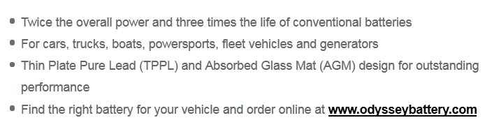

Quoting from their website:
[img]cid:.0[/img]
They go to great lengths to promote
maintenance-free features of the
gas-recombinant chemistry. I don't know
what that 'overall power' quality is.
On the other hand, I observe no disclaimer
stating that "3 times the life" can only be achieved
by visiting this website where we read:
"BatteryMINDers® from VDC Electronics are guaranteed
to double or triple the life of most batteries
while improving their performance.
To suggest that a battery maintainer
should be "optimized" for AGM is
not supported by the numbers.
A pre-mature failure of a battery stored
on a maintainer calls for verification
the maintainer's ability to support
ANY battery.

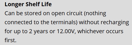

As to advertised self discharge rates we read:
https://tinyurl.com/y52e8zmx
[img]cid:.0[/img]
This is a poorly worded assertion . . .
'which ever occurs first'? Does this paragraph
imply that a 12v condition MIGHT be experienced
in less that 2 years. The paragraph should
be edited or eliminated. It offers no
helpful information.
A battery that has self-discharged to 12.00
has zero capacity . . . it's not damaged and
will recover gracefully but it won't start
an engine. Further, an extended slow-decay
has to be sulfation unfriendly.
For our purposes, and airplane that's
flown say, once a month, would not benefit
from application of a charger-maintainer
to keep the ship in flight-ready condition.
The effects of longer storage and/or extreme
conditions will be mitigated 100% by use
of a true, battery charger-maintainer.
