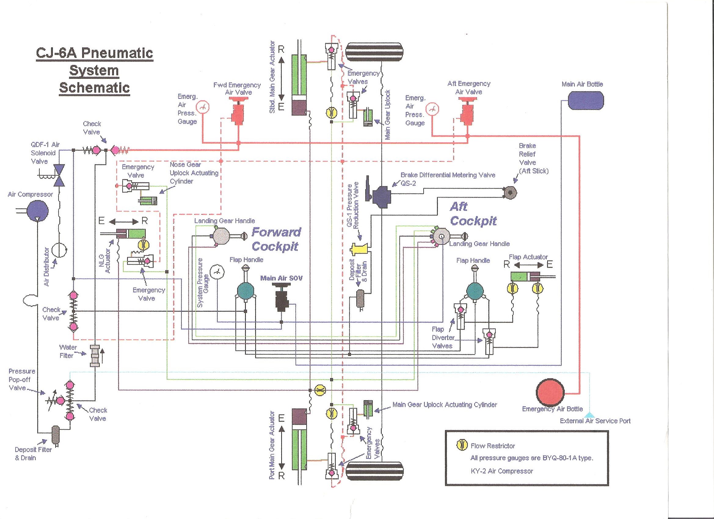

Dennis has you on the right track here but I am attaching a sketch with the
location of the the check valve that may have failed internally and is
leaking NORMAL system air into the EMERG. operating system.
That is assuming you did NOT do an Emergency down test prior to flight and
failed to bleed the system as Dennis described.
Walt
