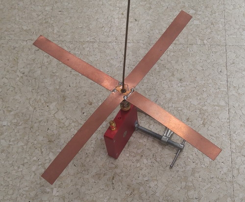

So borrowing from those knowledge nuggets, let's
take a look at this antenna. It's a simple, 1/4 wave
antenna I built for a telemetry receiver project
about 20 years ago.
[img]cid:.0[/img]
That little red box underneath is a vector
network analyzer.

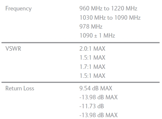

PostPosted: Sun Oct 06, 2019 6:47 pm    Post subject: Dual Band Antenna Question Reply with quote
At 08:24 PM 10/5/2019, you wrote:
I think that it not a dual band antenna. It is a wide band antenna that operates at both 978 and 1090 Mhz. Those frequencies are close enough together that most transponder antennas will work satisfactorily at either frequency. Someone please correct me if wrong.
Correct . . .
Stealing from the spec sheet:
[img]cid:7.1.0.9.0.20191006214029.006c2400(at)aeroelectric.com.0[/img]
There are 4 frequency ranges cited, 4
SWR limits and 4 Return loss limits
for each of the four frequency ranges.
They appear to have given themselves some
headroom for the total bandwidth and
call out 2.0:1 max . . . I'm betting it's
lower than that.
Return loss is just a another way of
stating SWR measured with a directional
coupler as opposed to an impedance
bridge.
 Filesize:  54.58 KB
 Viewed:  14599 Time(s)
