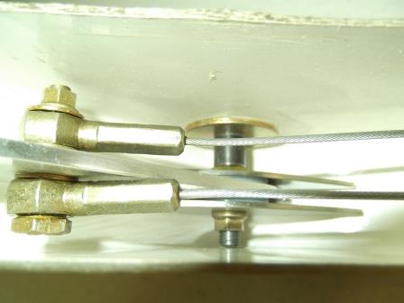

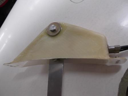

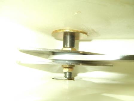

Hi Rowland
Pictures attached.
I glued the bolt into the throttle housing and made a couple of triangular plates that fitted snug into the bottom of the housing. The shape stops the plates rotating.
This stops any rotation of the bolt and no rotation is transmitted to the nut. The lever rotates between plastic washers, two either side of the lever.

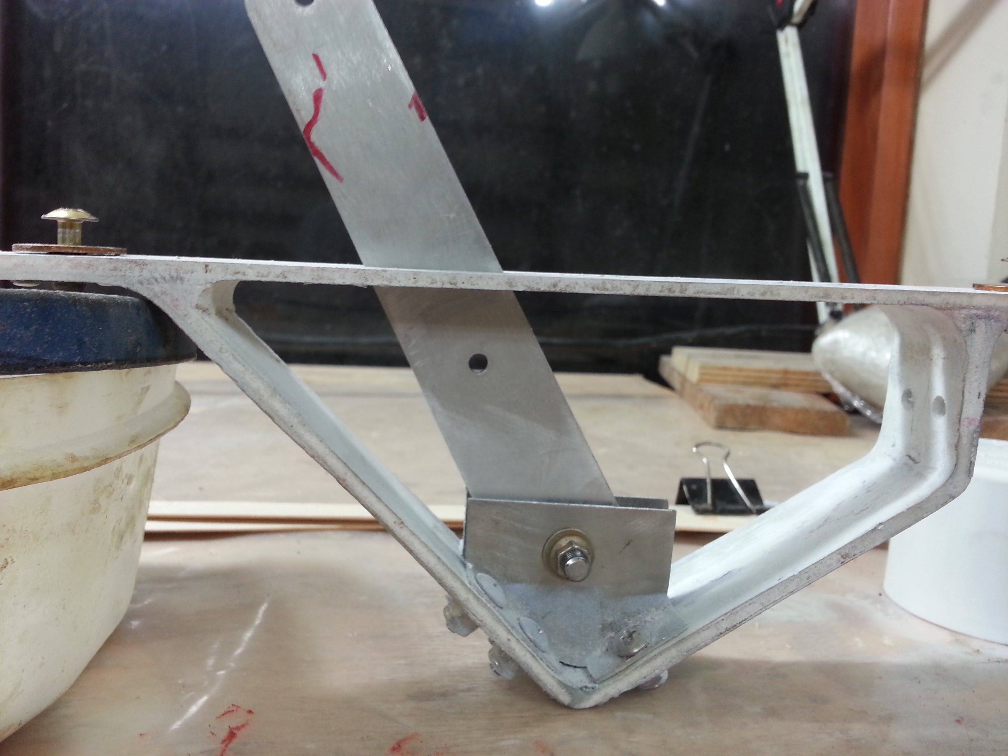

PostPosted: Tue Sep 17, 2019 11:38 am    Post subject: throttle pivot sifffnut won't stay in place Reply with quote
[img]cid:ii_k0o8wpc40[/img]
Kelvin - thanks, that sounds easy to do and quite obvious once you think of it! Thanks also to William - your approach is substantial and clearly effective, but I think involves too much re-work for me!
