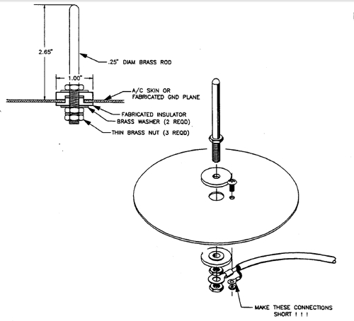

You said tube structure . . . fabric or metal skin?
If fabric, a 5.6" alum disk .060 or so thick
is an appropriate ground plane.
[img]cid:.0[/img]

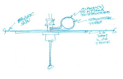

If your fabric is 'tight' against a structural
tube, then the ground plane can go on the outside
surface. It would look cleaner if between skin
and tube. One or more clamps should secure the
ground plane to structure . . . not for electrical
'bonding' but for mechanical support.
[img]cid:.1[/img]
Whether the ground is inside or outside the
skin, the antenna should mount in the center
with good electrical connection between antenna
base and the ground plane.

The DIY transponder antenna for composite
applications suggeseted a solid disk
ground plane with a radius equal to height
of the antenna.
[img]cid:.0[/img]
This 'plane' looks like an infinite number
of radials joined at the center. But
unless the plane is in pretty much free
space with respect to surrounding conductors,
it's near-ideal characteristics are
degraded.
For the purposed of our 'experiment',
the proposed 1/4 wave elements will be in
closest practical proximity to a metal
airframe; no longer in free air and
certainly not resonant at the frequency
of interest.
So the exact length is no longer significant.
Instead we're looking for some electro-static
or capacitive coupling to the airframe to
combine with planar effects of the now-random
lengths of conductor. In this case, the
wider strips taped to the skin are more
desirable to increase the capacitive coupling
effects . . . but the suggested wire elements
may well produce the desired effect of compensating
for a suspected inadequate ground plane.
