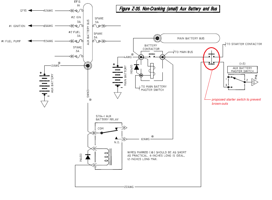

Folks, I have a few questions about Z-35, non-cranking aux battery and bus:
It seems like the Aux Batt Master Switch serves to separate the aux batt from the main bus, not to de-energize the aux battery bus.
Is the intention to leave the aux batt bus powered at all times, and to turn off aux bus users individually?
Also, would using a starter switch as illustrated be an effective solution to prevent brown-outs of equipment on the aux battery bus?
Thanks for your time,
DaveĀ
[img]cid:ii_k003qfx72[/img]

Disregard my brownout mod--that's what the switch is for.
Still curious about turning things off individually though.

Since the aux battery is connected directly to the aux battery bus, there is no way to
shut off power to the aux bus. Your logic is correct. Shut off individual loads.
