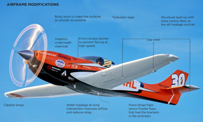

Im sure some of you have already seen this
[img]cid:ii_jz47lbyd0[/img]

William - no, what is it? Where did this image come from?

Aopa magazine this month.   These are the mods for a racing lancair.   They say it goes 400 mph.

I suspect that Mike Arnold would take issue with the notion that increasing the width of the fuselage at the wing intersection reduces drag. You may recall that Mike took his AR-5 to 213 mph on 60 hp…I believe engine was a Rotax 582.tps://oppositelock.kinja.com/who-was-mike-arnold-and-why-any-airplane-guy-must-watc-1794494964

Chris…That photo of the “racing Lancair� prompted me to revisit Mike Arnold’s work…I’d purchased his original VCR tapes years ago. Mr. Google led me to his youtube site and all of the follow-on videos…very sad to learn of his passing in 2015.
