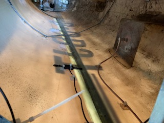

FLARM and SSR antenna in my Europa. They work fine with plenty of range and not impeded by the fibreglass fuselage.
VHF comm antenna is dipôle mounted on the rear fin as per the build manual. Again no range problems and all discretely mounted inside the aircraft.
Alan Burrill

 Filesize:  29.57 KB
 Viewed:  11457 Time(s)
