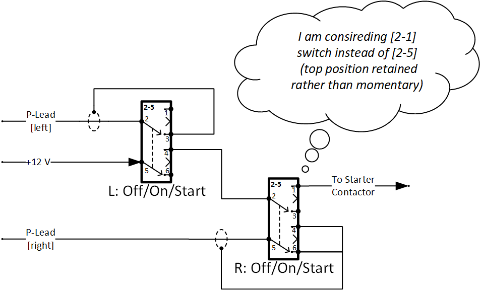

Starting / Mags Circuit
See "Mags / Start Circuit" sub-diagram attached at the end.
This is a deviation from Z-11, with both switches having to be in the momentary up position for starter to engage. I like this better for two reasons:
It makes the act of starting the motor more explicit, and
It returns back to correct "running" position automatically
I need to test the ergonomics of pressing up a couple switches together. If I don't like it, another alternative would be to replace the "Right Mag" switch circuitry from -5 to -1: making the top position on it non-momentary (as noted on the diagram). This will reduce the "user-friendliness" but will still keep the explicitness, especially with my using pull-to-unlock switches from Honeywell.

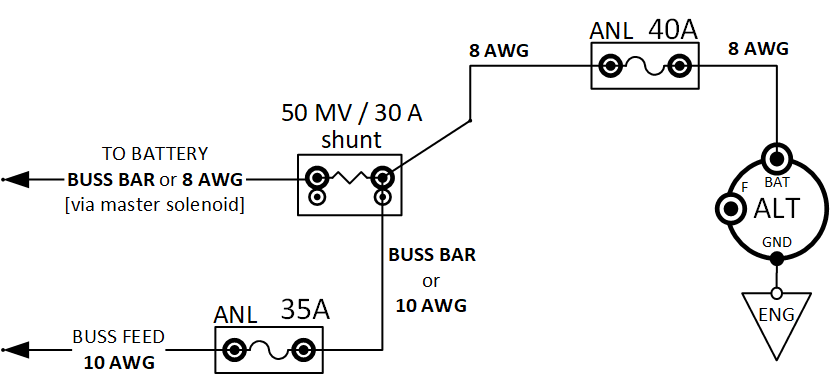

Main Power Distribution
See "Charging and Power Distribution" attachment at the end.
Note that:
Shunt is set up to be in the "battery" lead. I like "battery lead" style ammeters, showing charge current on the 12-o-clock-plus segment, and discharge current on the 12-o-clock-minus segment.
Note that the buss feeder wire is protected by a slow-burn 35A current limiter. In Z-11, that wire is not protected at all. My reasoning for this decision is that this wire is relatively long on my plane (around 4 feet), since fuse block is near the rear cockpit. I wanted to protect it.
One area of concern here is that in the event of alternator short, the Ammeter Shunt will be a part of the alternator circuit that will see a lot of current while the 40A slow burn opens up. My gutfeel says it should be able to handle it, but I am not sure. At any rate, figure Z-11 has the same setup with shunt on the alternator's B-Lead.

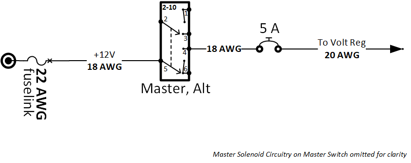

Voltage Regulator Field Supply Circuit
See "Field Supply Circuit" attachment below.
I copied the AeroElectric's figure Z-11 wire gauges here. In Z-11, everything upstream of Breaker is 18 AWG, and everything downstream is 20 AWG, but it's not explained why.
Is this driven by a requirement to ensure that fuselink survives the short in the circuit in case of crowbaring, and the breaker pops first, w/o endangering the fuselink much (18 AWG allows for 22 AWG fuselink instead of 24 AWG)?

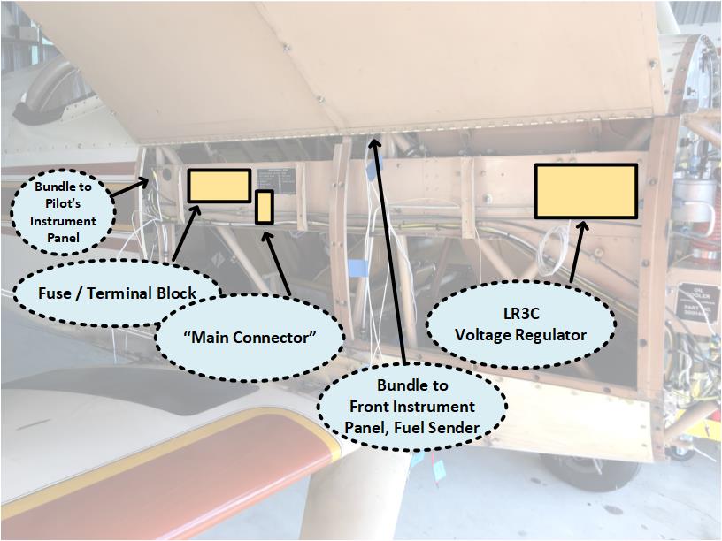

Component Locations and Main Connector
See "Component Locations" diagram in the attachments.
Note that logically, the way one would wire this airplane would be to pre-wire switches and other items that go into the pilot's (back) instrument panel with long pigtails, then install the switches, and tie down wiring behind the panel. Then, the pigtails can be connected to fuse block and loads.
Some of the load wires already exist (lighting for example), and they will have to be spliced to wires coming from switches.
I have decided instead to locate a kind of "Main Connector" right there near the Fuse Block. A wire comes off of the Fuse Block, goes to the switch on the panel, then switched power is returned to the "Main Connector". Load is on the other side of Main Connector. This works for most with a couple exceptions.
This serves a couple purposes:
Create a logical "access point" into the main wire bundle, for reading labels, tracing wires later, and such,
Simplify installation process
Connect to existing load wires that are not being replaced
For now, I am thinking about using Molex 0.093 pins in two housings (I have 13 circuits total to connect via this thing, and want to have room for further expansion). I would love suggestions here. One of the requirements is that it should be easily workable with a multimeter for tracing / testing purposes (I technically could've used D-Sub here , but am not due to this precise reason).
 Filesize:  23.17 KB
 Viewed:  7293 Time(s)
 Filesize:  15.94 KB
 Filesize:  10.62 KB
Component Locations
 Filesize:  62.71 KB

That main connector is an unnecessary failure point. There are two crimps and the mating pins, a total of 3 failure points for each circuit. And since there are 13 connections, luck in not on your side. Smile Straight wires with no splices would be much more reliable. How often will it be necessary to unplug that connector? Compare the convenience of unplugging that connector to the inconvenience of troubleshooting and fixing a bad connection.
Consider eliminating the 35 amp ANL fuse. There is a reason the main power bus feeder is not fused in Bob's drawings. If it fails, all electrical power is lost. Compare that danger to the chances of the feeder shorting out. If you practice good workmanship, support the feeder well, and double insulate it where it passes through the firewall, then it is not going to short out.
The shunt location is a matter of personal preference. I prefer to measure alternator output rather than battery current. Or eliminate the shunt altogether, one less thing to fail. The voltmeter will tell if the alternator is working or not.

> main connector as 3 failure points per circuit:
It will probably not gonna get disconnected ever, unless serious repairs are necessary.
This connector is weighed against the fact that absence of it will make troubleshooting extremely aggravating and time consuming, should it ever become necessary; given the physical layout of things and that I am retrofitting here (if I was building the whole new panel, I'd architect it with using sub-panels or similar with easy access). It will also make assembling the system much easier (though I understand this is not a strong argument given that my labor on the plane is $0/hour Wink ).
Suppose I'm using Molex 0.093 crimped pins. I can greatly improve reliability by paying utmost attention to each pin's crimp, or using a touch of solder if I doubt them (or, just using solder to ensure the connection is electrically sound). I do have a good crimper, having tested a few crappy ones Smile.
Just to give you an example: let's say, my Master Switch circuit isn't doing the right thing. If I have the Main Connector, I effectively have access to the "switch" side of things, as well as the "load" side of things to trace and measure. If I don't have it, I only effectively have access on the load side; and accessing the switch side requires a lot of contortions.
Side note: when tracing old wiring (which lead to this project), I did have access to things on a similarly set up "terminal block" - and I still, climbing the XXXth time around the flying wires, managed to twist out my knee such that I was immobile for a couple days
What would be great is if someone could suggest the connector type to use here.....
- Milspec terminal block: too bulky
- "Transformer"-style terminal block with #6 screws - possible, though security of those screws needs to be considered; and it's heavier (relatively)
- Molex - I was looking at 0.093 series and the MLX series. I want "backside access" for multimeter probes...
> consider eliminating the 35 amp ANL fuse.
Possible fire hazard vs slightly higher probability of total electrical failure is basically the tradeoff here. I erred on the size of virtually eliminating former at the expense of small increase of probability of the latter (someone accidentally dinging that wire without noticing is also in realm of possibilities, however remote).
I do have somewhat an elevated fear of letting the magic smoke out in this ship because of it being a tube and rag, with gas tank between the passenger's legs kind of ship...
On the other hand, my reasoning was that I actually am completely non-dependent on electrical system on this plane - while annoying, even at night, it is not required for the safe completion of the flight. Yes, I will lose my tach, engine 3-in-1, radios, and lights - but that's a minor affair in a $100 burger airplane IMHO.
Now, an interesting question is what are the chances of the buss feeder ANL opening without a good reason? If they're known to do that, then this might be a consideration...
Note that I'm sizing a 35AMP ANL for a setup where all downstream fuses are 5A or less except for one other, buss -> radio stack, feeder wire (which I will try to make as small as I can). My understanding of ANLs is that they will be able to withstand shorted circuits blowing small fuses downstream...

A trick that I have used for troubleshooting and testing a wire, when there is no test point, is to poke through the wire insulation with a needle or Exacto knife. Probe that sharp object with the voltmeter. The small hole in the insulation requires little, if any, repairing.
Having a connector will make troubleshooting easier. On the other hand, if that connector wasn't there, then there wouldn't be any trouble to troubleshoot. Smile
An ANL fuse is unlikely to blow. However, the crimped terminals and fasteners are unnecessary failure points. And bare terminals present a short circuit hazard. So the fuse is creating a hazard that it is intended to protect against.
