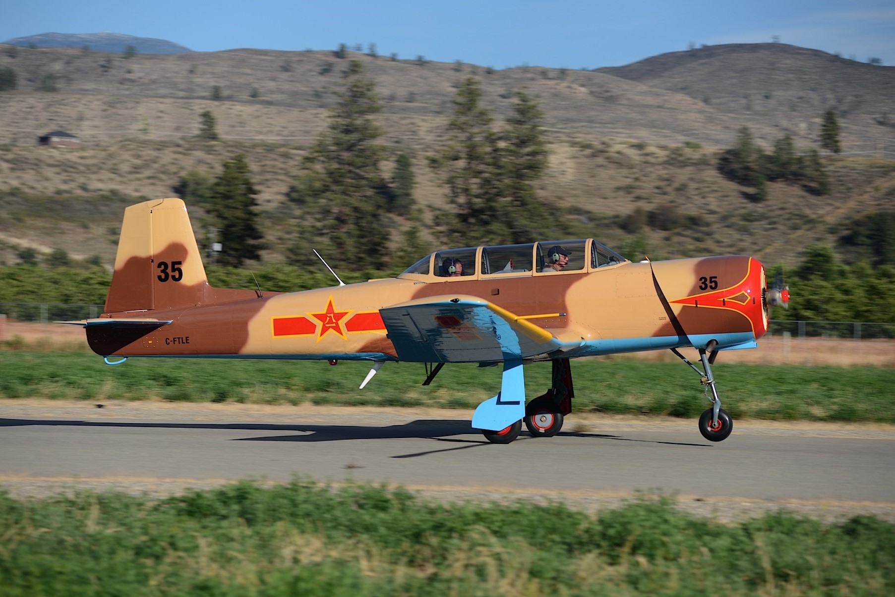

I just lift the NW a bit when I'm going in the right direction and let it
fly off when it's ready. Seems to work!
The attached I think shows it close to lift off. Note the elevator
position.

Damn!
forgot the pic.
