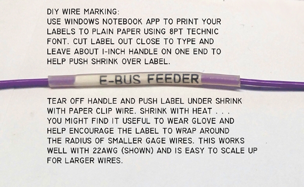

Another option:
[img]cid:7.1.0.9.0.20190801124848.009a1ff8(at)aeroelectric.com.0[/img]
 Filesize:  181.9 KB
 Viewed:  16180 Time(s)

PostPosted: Thu Aug 01, 2019 12:28 pm    Post subject: Marking Wires Reply with quote
At 11:06 AM 8/1/2019, you wrote:
You're right; it won't shrink enough for 22 AWG wire. Shrink some small, unmarked shrink tube on the wire. Then shrink your label over that.
Another option:
 Filesize:  181.9 KB

rlborger(at)mac.com
PostPosted: Thu Aug 01, 2019 2:17 pm    Post subject: Marking Wires Reply with quote
Sebastian,
I have used a DYMO printer for wire marking for years. Works great. Art’s suggestion for 22AWG should work for your teeny wire.

PostPosted: Thu Aug 01, 2019 5:00 pm    Post subject: Marking Wires Reply with quote
1/4" is the smallest for the Dymo. I think I'll order a bunch of clear heat shrink and use Bob's method.
