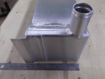

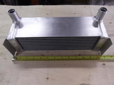

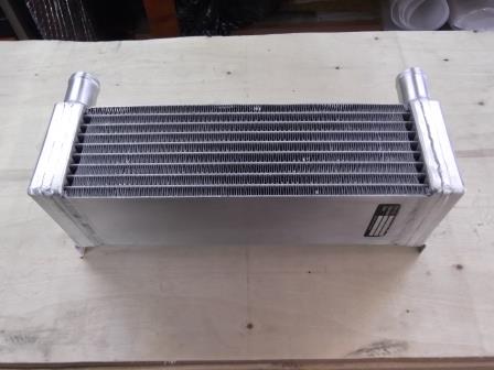

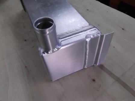

I have attached some photos of the radiator which might help if you need to find a custom made item. Hopefully, Karen at Europa will be able to help find a solution.
The dimensions are:
Core is 3 3/8 inches from front to back and 3 1/2 inches tall.
Radiator body is 12 1/4 inches wide overall with 12 1/2 inches between the outside (mounting surface) of the flanges.
The inlet / outlet pipe is to suit a 1 inch hose
 Filesize:  44.76 KB
 Viewed:  26752 Time(s)
 Filesize:  52.2 KB
 Filesize:  45.38 KB
 Filesize:  49.39 KB

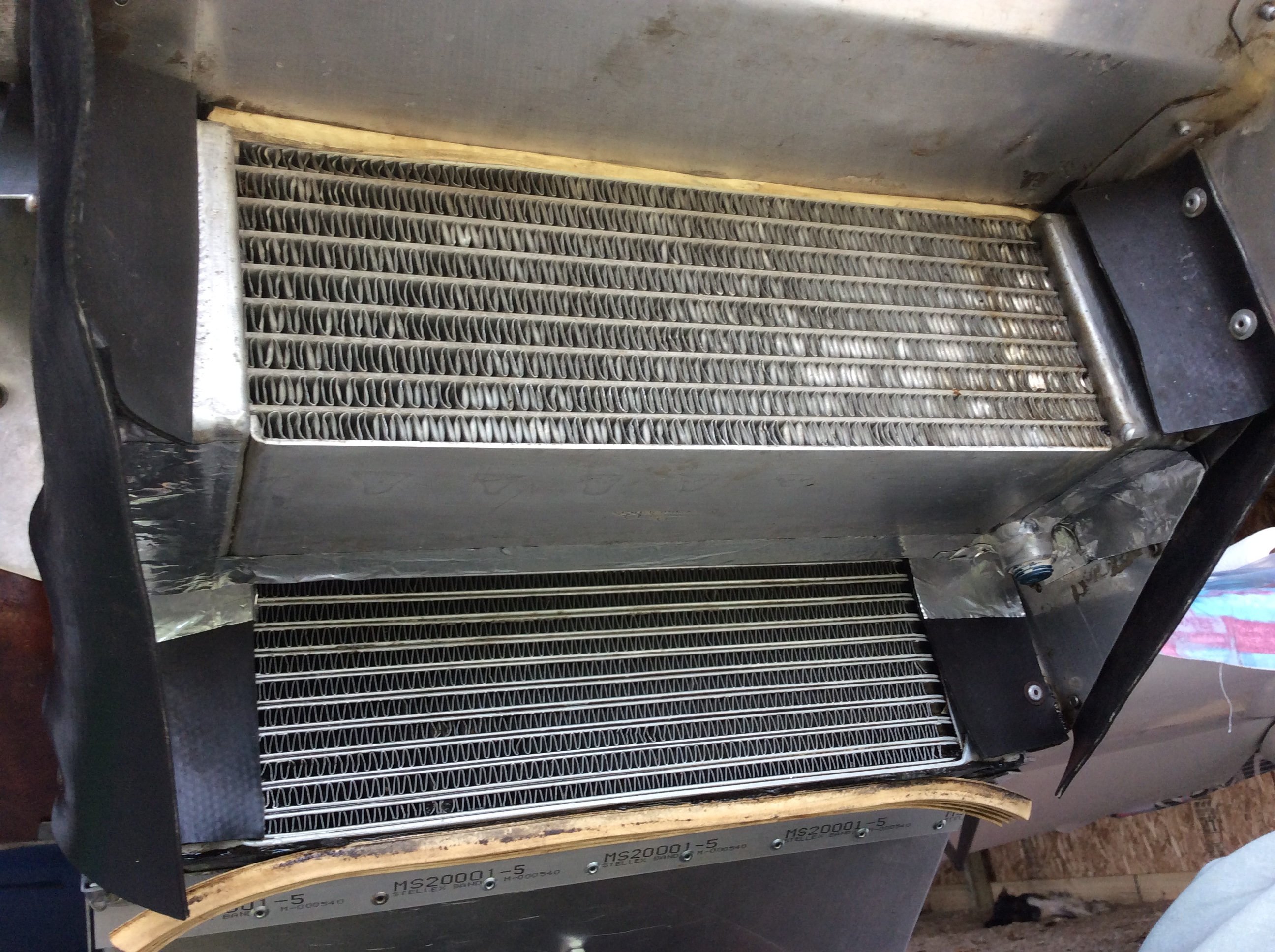

A worthwhile modification is to add a drain on the bottom port side of the coolant radiator. Otherwise to drain the system you either have to siphon the coolant or pull off the hoses. Either makes a huge mess.
Jim
