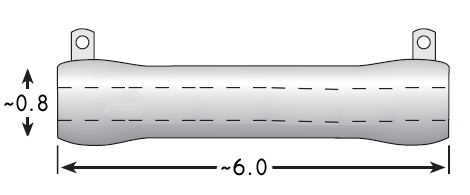

Hmmm . . . I seem to recall that COIEK is
a old-line resistor manufacturer . . .
[img]cid:.0[/img]
A resistor of that size would look about
like this?
28 volts applied to a 125 ohm resistor
dissipates only 6 watts. I'm having
trouble imagining how a resistor of
that size gets overheated in a 28v system.

The pic shows multiple taps; looks like some of the individual segments could easily be as low as around 20 ohms. Those are some really fat looking conductors attached to it, too.
