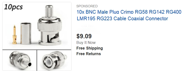

Could somebody kindly answer the following questions:
- Are BNC connectors for RG-58U wire and RG400U wire the same?
- Can the same crimpers be used for attaching BNC connectors to both RG-58U wire and RG400U wire? If so, why you can only read ‘58’ on some dye sets and not ‘58/400’ or something like that?
- What about TNC connectors? Do the same principles as for BNC connectors apply when it comes to RG58/RG400 cables and installation tools?
BNC and TNC connectors are crimped with
the same hex dies. 0.213 for the shield
and 0.068 for the center conductor.
As indicated in this ad:
https://tinyurl.com/y5poy9dc
[img]cid:7.1.0.9.0.20190714210030.06111f70(at)aeroelectric.com.0[/img]
All coax types listed are 0.195" nominal
o.d. and will install on the same connector
 Filesize:  86.92 KB
