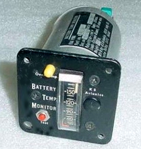

Had some similar thoughts back in the hey-day
of wet ni-cads finding their way onto airplanes.
A number of airplanes suffered battery fires
due to high rate energy replenishment after engine
start. The same conditions contributed to
root cause. Smaller batteries with lower
thermal mass. Lower internal resistance
translating into a battery's willingness to accept
replenishment.
The 'fix' was to add crew monitored
battery temperature warning systems to
the airplane. Here's an example . . .
[img]cid:.0[/img]
The idea was that when the yellow light
came on, the crew would disconnect the
battery from the bus until the temperature
fell to happier territory.

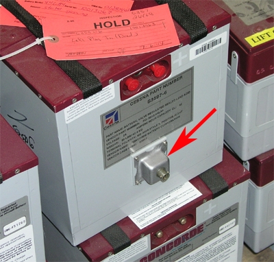

In years since, improvements in lead-acid
technologies lowered cell impedances
to the point that RG batteries were
subject to discharge/recharge overheat
in a/c with large generators. So
lead-acid batteries began to sprout
connectors to carry temperature sensor
data to . . . you guessed it . . .
the cockpit mounted warning system.
[img]cid:.1[/img]
  replenishment.
[img]cid:.0[/img]
[img]cid:.1[/img]
