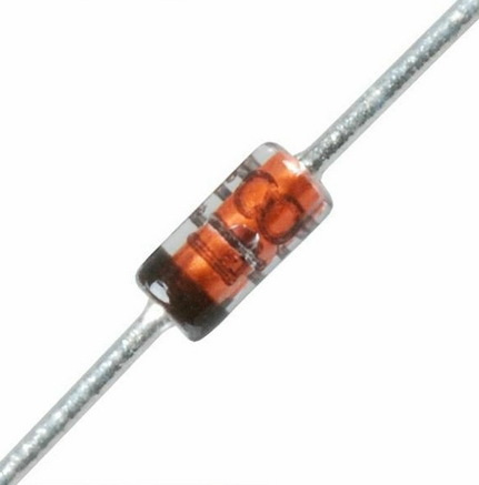

[img]cid:.0[/img]
I did some testing on various
zeners and found that only GLASS enclosed

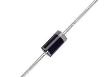

[img]cid:.1[/img]
This is why the zener could only be
'legally' replaced with the Grumman house
part number to make sure that the part
was GLASS encased.

[img]cid:.0[/img]
could be depended upon to fail shorted . . .

[img]cid:.1[/img]
was GLASS encased.

BTW, the diode we removed appeared to be plastic (like the one in your second
attached image), not glass.
