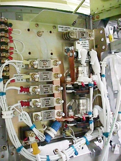

I suggest you not worry about it. We had
some discussions about this waaayyy back when.
One builder suggested building a cover for the
contactor intended to shield 'dangerously
exposed terminals' from accidental contact/shorts.
Bad idea . . . these critters run warm NORMALLY
and are designed to perform in 'open to
the environment' conditions. Any enclosure
could emulate a tiny oven where the contactor
is deprived of expected air flows.
[img]cid:.0[/img]
Consider this picture I took on the A36
production line at Beech. Talk about
spark-hazard-city! Yet, just like the
bus bars behind the breakers, these
are considered to be exceedingly unlikely
sources for sparks-in-the-dark . . . or
otherwise.
