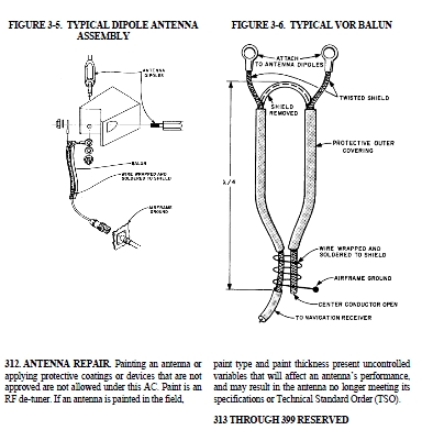

I've seen this design in documentation for
aviation radios . . . in fact, we find it
in AC43-13 dated 2008 and . . .
[img]cid:.0[/img]

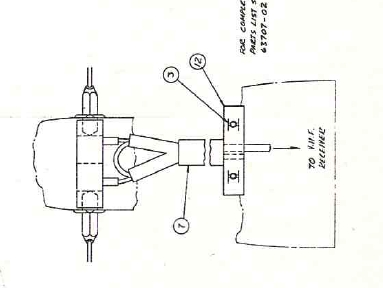

in this illustration taken from the installation
manual circa 1949 for a Lear LTRA6 transceiver
[img]cid:.1[/img]
Where Item 7 is called out as a 63184-02
Transmission Line Assembly but without
further details as to how it's constructed.

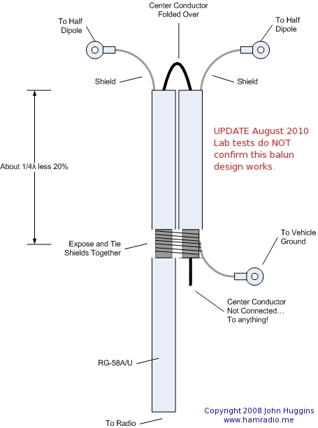

The design is echoed on numerous websites
as an 'aviation antenna balun'.
Two flies in the ointment: First the callout
for "1/4 wave" is not defined. Free air or
in coax. Second, the balun is noted in an
article by a competent observer of things
electronic where he states, "Lab tests
do not confirm that this balun works."

Okay then . . . when I'm ready to put the
signal generator on Jim Weir's dual band
ELT antenna to investigate common mode chokes,
I'll be able (1)to confirm/deny the functionality
of this design (2) reconfirm functionality
of the Pawsey Stub balun described in many
articles and echoed on my website and (3)
see if a ferrite core common mode choke would
be a less fussy way to mate coax to the cat-whisker
vor antenna.
