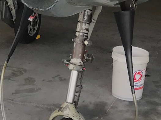

Due to the quality of the grass strip at my base, I’ve sheared this bolt on the nose gear. What do I need please? The Parts Manual says HB1-503G1x70x10 but I need that in British English please.
M6x10mm or something else? High tensile presumably...

Unless I have missed a photo here the only thing I see missing is a grease
fitting plus one hell of a messy nose gear.
If this is your missing part I would have to assume you do not have a
Chinese (or Russian) grease gun and occasionally use it, otherwise you could
not possibly
mistake this for a bolt.

Yes Walt is correct. That’s a grease nipple that’s missing.

It seems mine isn’t stock then. This is the other side...

That is a stock Chinese grease fitting.
That is what is missing from the other side.
