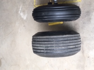

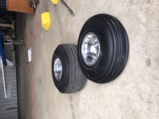

Rusty, I’ve basically ran those very brands for many years. Your worry is not realistic. I now run Black Max brakes and one piece wheels. I have two sets , 6”inch wide for my booney tires 15 X 6 and 6X4 Aero something from Aircraft Spruce for paved runways. There rated for 70 mph.
Both set are mounted tubeless. I’ve never in 34 years of flying ultralights had a blowout.

 Filesize:  30.65 KB
 Viewed:  26181 Time(s)
 Filesize:  27.15 KB
