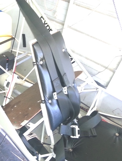

I know that you are looking for "Off the Shelf", however, for sizing, comfort and price, I chose to make my own. Biggest issue being size. At 6'3", I couldn't afford to give away any more room than necessary.
The foundation for both the back and the bottom are from 1/4" plywood.
For the back , used 1" thick foam.
For the seat bottom, I used seat cushion foam (memory foam) from WICKS. There are different thicknesses and densities. Your weight and sitting height will dictate these. (I think I used 1 1/2" thick, medium density.)
The 1" foam for the back and black vinyl for covering both the seat and the back came from a local fabric shop.
For added safety, I used sheet aluminum (at least .090, maybe .125) for the seat bottom. Fabricated a similar setup for the rear seat. Used fabric shop foam for the back seat cushion to lower cost. The rear seat setup is easily removeable.
The attached image will give you a general idea of the setup. Sorry there's not a better shot of the seat bottom. If you need additional images, let me know and I'll try to get some within a week.
