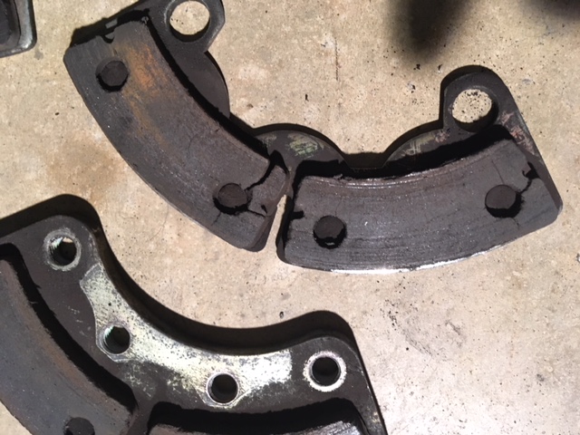

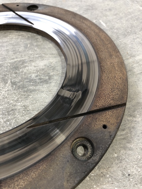

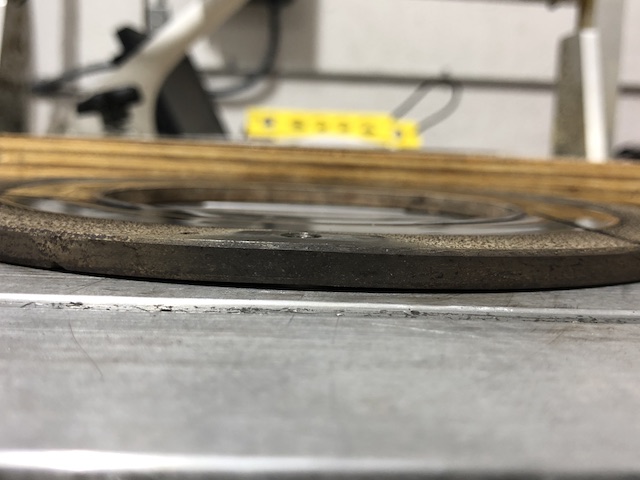

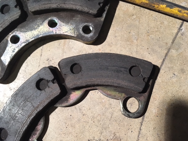

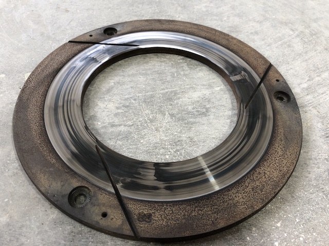

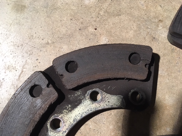

Hi list,
The brakes have me stumped.  I recently removed my brake linings (Matco brakes) and found that they were showing checking/cracking as shown the attached photos.  In speaking with Matco, I learned that this is caused by excessive heat which is likely caused by the brakes dragging.
Matco suggested that I should be able to squeeze the brake pistons by hand and cause them to retract (makes sense).  Unfortunately, this was very difficult to do with mine, indicating there is some sort of restriction.  To narrow this down I sequentially:
- Bypassed the notorious parking brake valve
- Disconnected the master cylinder pushrods from the pedals to ensure they're fully extended
- Removed the reservoir cap (why not)
Despite these changes I still find it very difficult to squeeze the pistons in.  I'm starting to wonder if it's possible that a) my -3 Bonaco brake lines are restrictive, b) there's another problem I haven't thought of, or c) that is is all a wild goose chase and it's always hard to squeeze the pistons in.
Any ideas out there?  I'd appreciate the help.

Looking at your photos, yes, it is possible they got a bit hot. However, it is also possible the rivets were squeezed a little too tight. That will cause cracking around the rivets.
They only need to be tight enough that you can't move the pad on the backing plate by hand.

If the inner shoe pad doesn’t move freely, you may want to examine the spacer they ride on. Similarly there is another set of spacers the calipers ride on. Can you move either of these freely with you hands?
Have you checked your rotors to ensure they aren’t warped? The same goes for the plate that the pads are riveted. They can warp if over heated to.
It wasn’t until I replaced all of these that brakes started functioning properly. I can’t say these are your issues, but it does give you other things to check.

I had the left brake drag on the RV-10 at about the 100 hour point. It was so bad the left tire lost most of its inside tread.
The problem was a rolled O ring on the brake caliper piston. I replaced the O ring with a standard one from Van’s and it has been trouble free for 500 hours.
I agree that it looks like the brake pad rivets were squeezed too tight.

Mine has been doing that for a while and I think i just now fixed it.
The discs were warped and that was overheating the calipers/pads even when not using the brakes.
Replacing the discs only didn't help. Adding return springs on the master cylinders didn't help.
The pads crack just as well with Matco's SwiftLine pad/shoe that they rivet together themselves. So I doubt it's an oversqueezed rivet problem. Plus the whole pad looks charred by the time it cracks around the rivet holes.
This time around I replaced the shoes, pads, the pins, everything. Also put thermocouples on both calipers. AFS has two TIT thermocouples inputs so my caliper temps are showing on the screen.
The one thing I learned from that exercise is that when I hold onto the brakes after landing i can see the temps zoom up above 200F in seconds, otherwise they stay below 130F.
Just tap them and let go and the heat from the disc won't have time to transfer over to the pads.
Lenny

PostPosted: Mon Apr 29, 2019 11:36 am    Post subject: Re: Brakes have me stumped Reply with quote
Clearly visible. Attached some pictures.
Lenny
digidocs wrote:
Lenny,
This is very interesting.  How did you determine that the discs were warped or was it obvious?  Hopefully you've found the issue now!
David
