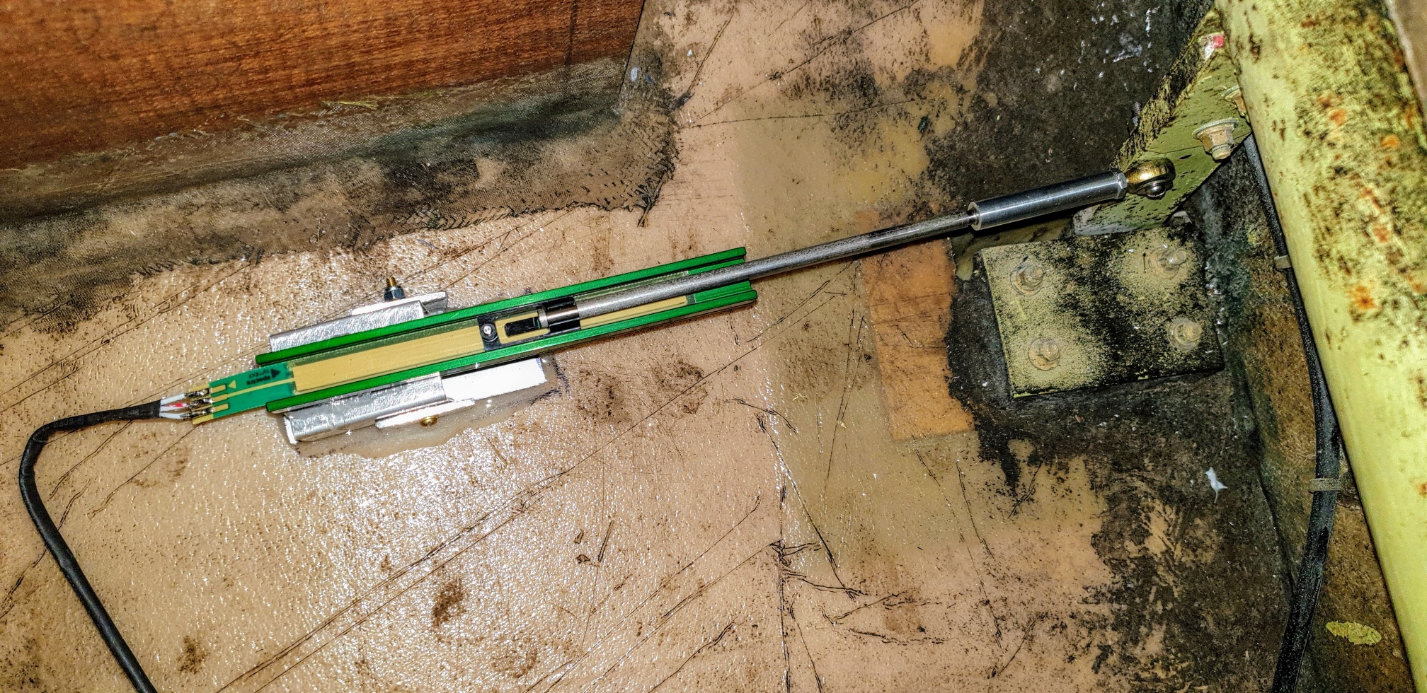

Hi Emmanuel,
I fitted a slider type potentiometer to my XS to allow my Dynon Skyview EFIS to display the flap position. I've attached a picture. You can get them from suppliers like RS Components. I just drilled a small hole in the flap arm to attach the slider arm and then bonded the unit to the fuselage.
Hope this helps.
Carl
