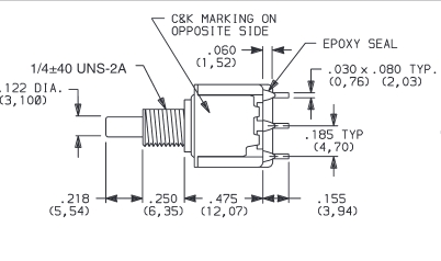

Do you care about the size of the button? Push
buttons with 1/4" barrels are pretty small.
[img]cid:.0[/img]
C&K 8121SHZGE SWITCH PUSHBUTTON SPDT 1A 120V
 Filesize:  41.62 KB
 Viewed:  17248 Time(s)

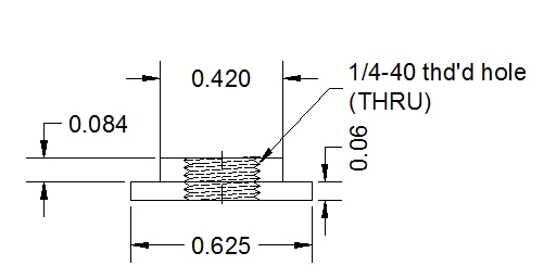

PostPosted: Sun Apr 21, 2019 8:38 pm    Post subject: metric threaded switches Reply with quote
At 08:39 PM 4/21/2019, you wrote:
hi bob, panel is .062. overlay is .02 and panel hole is .433.
Yeah, the miniature breakers are 7/16-32 thread.
Here's what I was trying to describe:
[img]cid:7.1.0.9.0.20190421225936.05eb0db8(at)aeroelectric.com.0[/img]
I think I've got some alum rod stock
and a 1/4-40 tap around here. Could
probably cut this out for you in the
not too distant future.
The C&K push button would
thread in from the back with enough
protrusion to install one of the nuts.
You could probably assemble the washer
and nut onto the switch and then bond
it into place.
 Filesize:  36.99 KB
 Viewed:  17221 Time(s)
