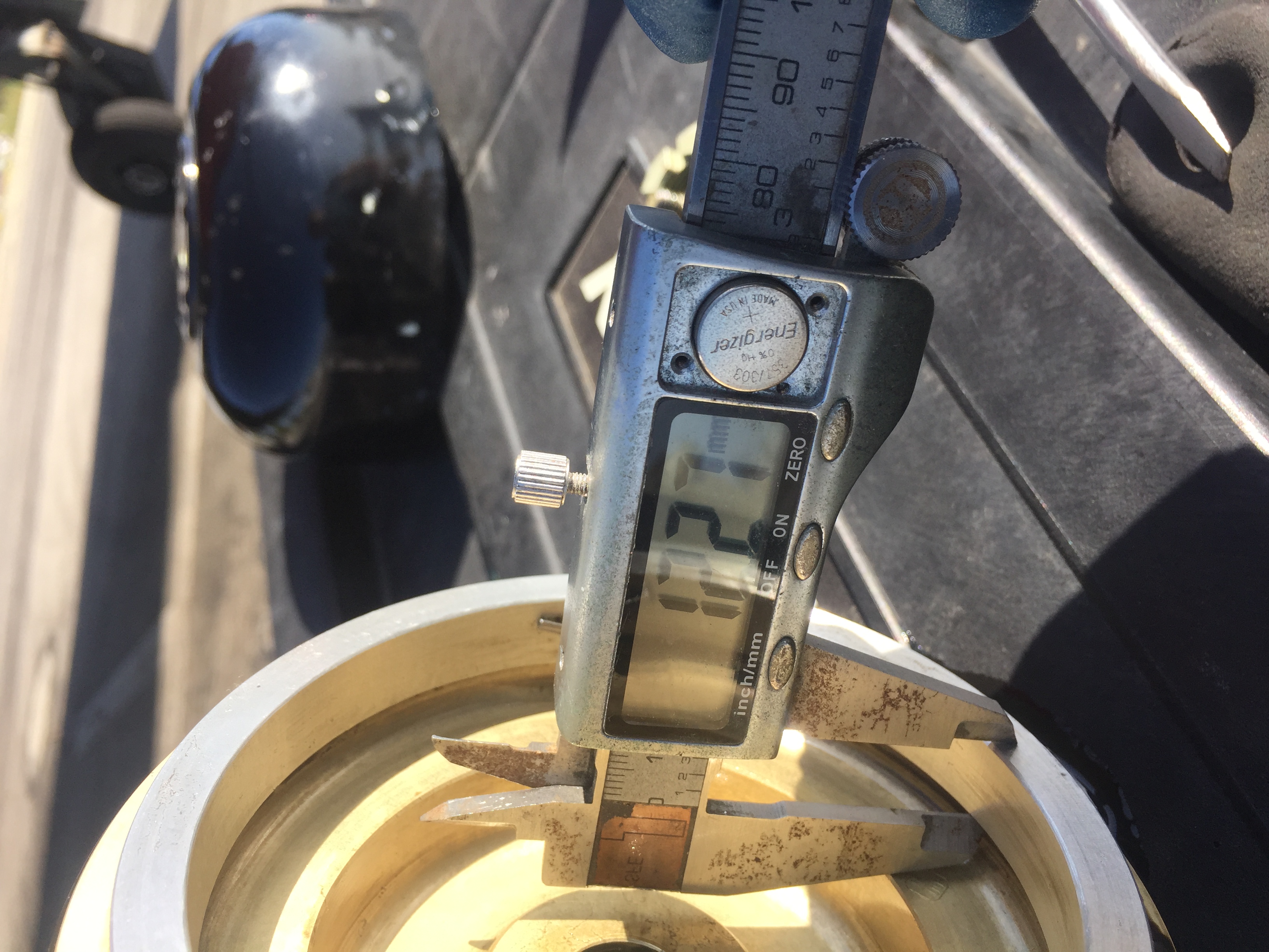

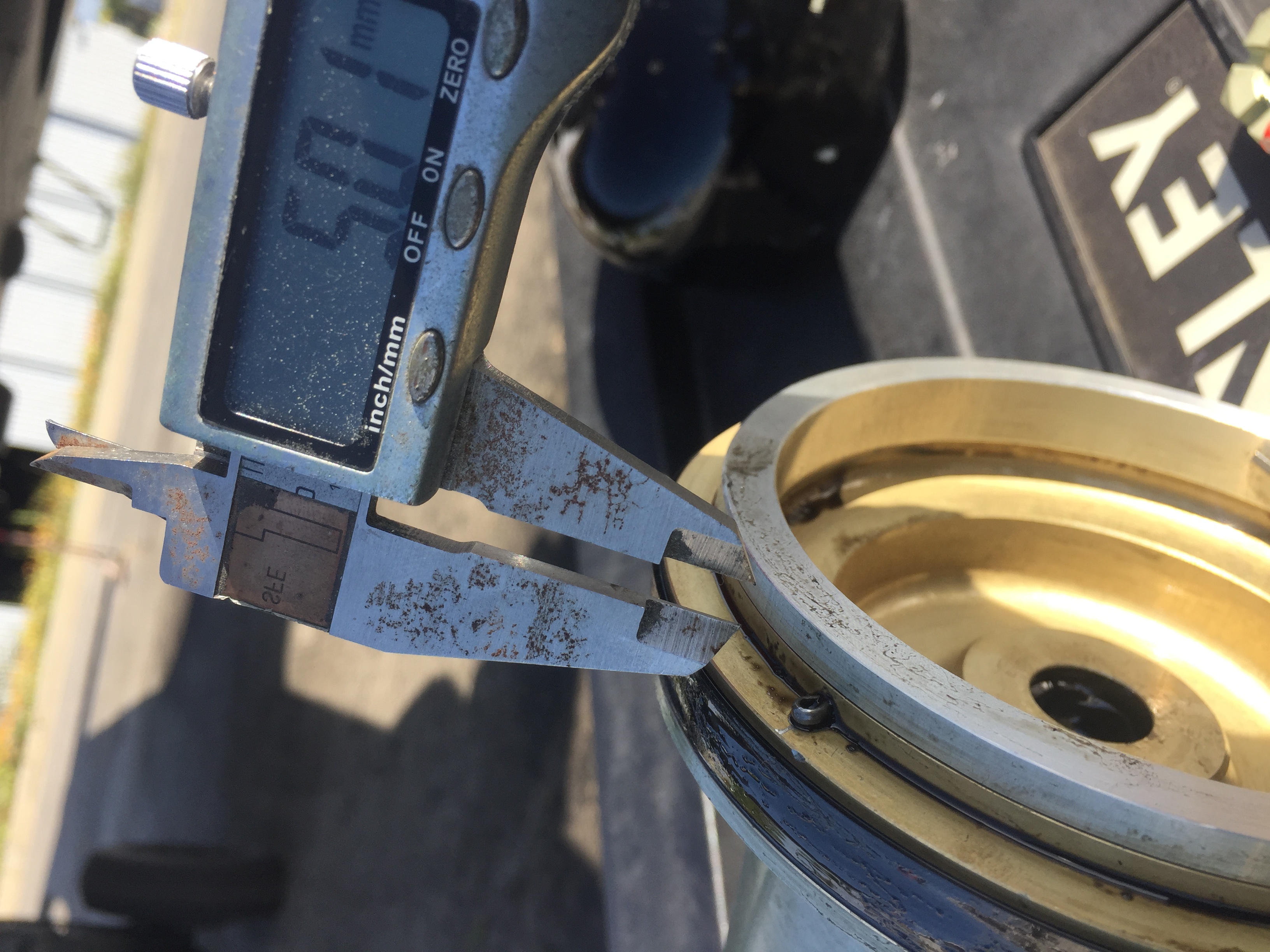

I measured the ring. While the ring itself is 12mm thick, the part that extends beyond the piston is 5mm. See attached pic. I do not foresee that this is the problem but I’m here for your advice.
Gil

PostPosted: Mon Apr 22, 2019 6:12 pm    Post subject: Prop won't slow below 70% Reply with quote
That is a stock M14 ring. The course pitch will be approx. 35 deg. so back
to the drawing board.
Sorry!
Walt
