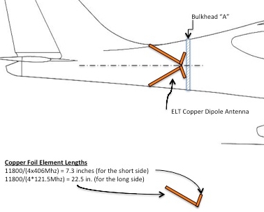

Might be easier to ditch the whip antenna
and go with the RST design semi-dipoles
discussed here on the List about 7 years
ago:
https://tinyurl.com/yyz6anjs
This antenna is a dual frequency DIPOLE
that does not require a ground plane.
It mounts no the side of your fuselage
inside surface.
What is the material used in your
airplane's construction?

The aircraft is a KIS made from honeycomb and fiberglass
On the dipole antenna what length should the folded balun be and do I make the toroid balun with 3 toroids as in the instruction?

In the mean time, fabricating uncle Jim's
paralleled dipoles arrangement is easy.
Attaching directly to this antenna with
coax is also easy.
[img]cid:.0[/img]
It seems that your airplane (epoxy/glass)
is a likely candidate for an all internal
ELT antenna which would, I suspect, be
less vulnerable to damage by unintended
arrivals with the earth. Best yet, no
ground plane . . .
