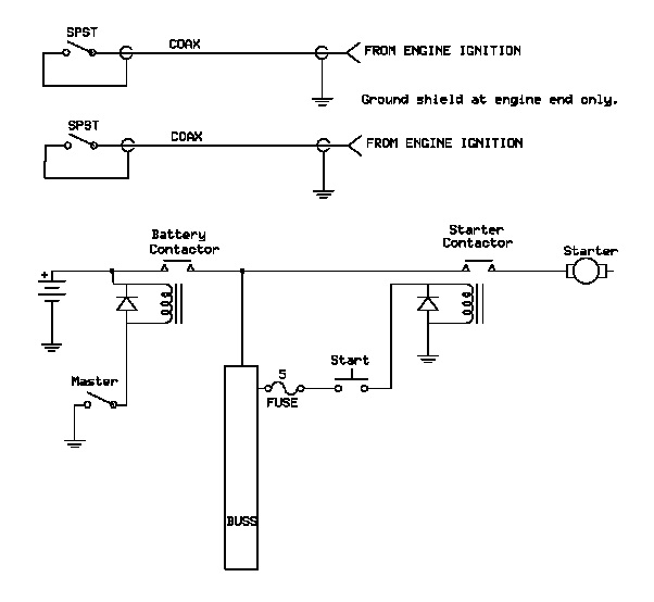

Below is a drawing showing how to connect ignition switches and start switch.
 Filesize:  40.35 KB
 Viewed:  6167 Time(s)
Joe Gores
