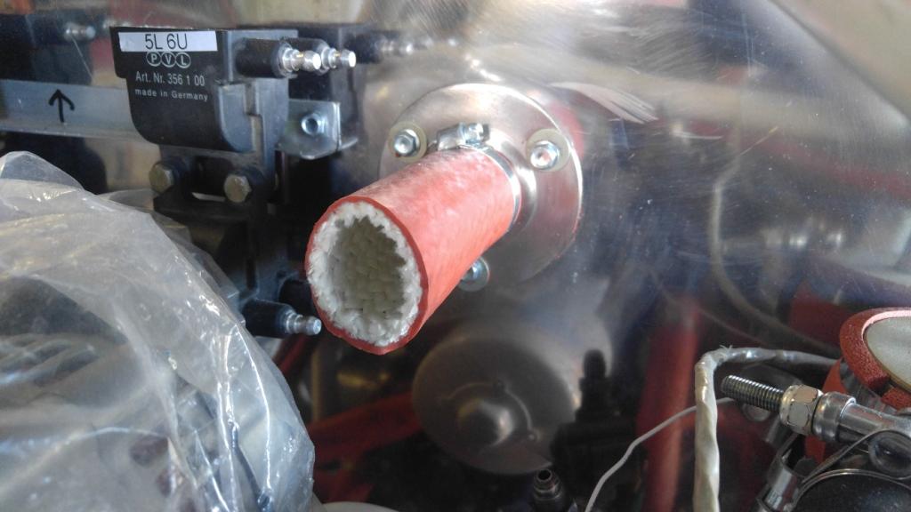

I am looking for an “engine compartment proof” connector for a 9 conductor ignition sensor cable so I thought I would ask the pros at the Aeroelectric list for help…again.
I have an engine that has dual Lightspeed Plasma III ignition systems and I need to remove the engine to gain access to the accessory case.
The dilemma is that the two cables (containing 9 conductors each) that run from the crank sensor at the nose of the engine to the ignition modules mounted on the cold side of the firewall are too short to be able to move the engine out far enough to gain access to the accessory case…the crank sensor end of the cables are soldered to the crank sensor PC board and the ignition module end is on the cold side of the firewall and it has D-Sub connectors that are too large to pull out through the firewall wire conduit (see picture of conduit before all of the other wires were run through it.
So I am considering cutting the 9 conductor cables in half on the engine side of the firewall and using some kind of VERY RELIABLE connector to splice these VERY IMPORTANT cables.
Does anyone have any product recommendation? D-Sub (liquid proof male and female hoods)??? Deutch connectors??? I would prefer a metal connector body although I do not think it will really matter.

I use a 25-pin Dsub with the female side mounted from the inside of the firewall. It is a ceramic filled Dsub, so that in the case of a fire it will be more resilient than the galvanized steel that Zenith specifies for the firewall. All of the engine instruments, including the CHT and EGT probes go through that Dsub.* It makes for a very clean installation. If you have the Dsub on one side already, consider just making that parallelegram hole, and being done with it.
*I just crimped a pin onto the end of the wires. If there is more than 1* of difference between the wires inside of that connector, I'll be a monkey's uncle. Wait. Given my nephews, that may be the case already.
The most robust/reliable is to simply extend the harnesses
with additional wire SPLICED onto the original harness
such that excess wire forms a service-loop that is
coiled and tied off for normal operations.
Close cousins to these connectors are found under the
hood of bizillions of vehicles. They are dust/water
tight.
https://tinyurl.com/y3yl5ls2
