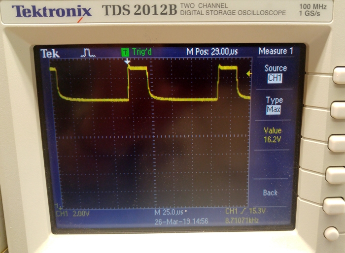

The latest/greatest specimin in the
stable of Battery Tender wall warts
came in.
I dug around in the shop and came up
with an SVLA battery out of a portable
air compressor that showed about 9v
open circuit. When impressed with 14.2
volts, charge current stabilized at
about 0.4 amps and would not go any
lower. After being on charge for about
5 hours, I loaded it with 1A and the
terminal voltage fell to about 11 volts.
I.e. capacity of zero.
I deduce that no cells are shorted.
I hooked it to the new Battery
Tender and invoked the maintenance
mode.
Here are the pertinent pages from the
users manual.
http://www.aeroelectric.com/articles/Batteries/Battery_Tender.pdf
With a 'scope hooked to the battery we
see this:
[img]cid:.0[/img]
Yeah, it 'hammers' the battery with 25uS, 16v pulses
probably 2A or better at an 8.2KHz rate.
I saw no signals that suggested credence for the
magic 3.26Mhz 'resonant frequency' of lead sulfate . . .
which I think is bogus. How any physical mass of
those dimensions might offer resonance at a
wavelength of 97 meters begs some light-
footed explanation.
Nonetheless, the product does have a 'hammer'
mode. The literature suggests that a badly sulfated
battery may require weeks of rejuvenation . . . this
test article is in pretty bad shape so we'll
let 'er cook.
BTW I see that BatteryMinder has come out with
a 'desulfator' product.
https://tinyurl.com/y4682h48

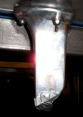

The pitot head is from a Cherokee, looks like this

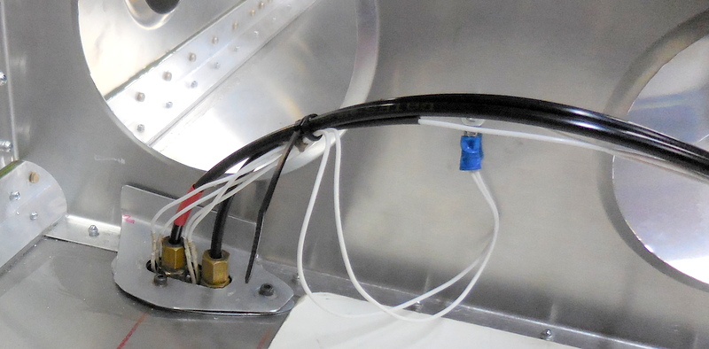

Here's a picture of the wiring inside the wing during construction
[img]cid:ii_jtzuk28o1[/img]
which looks possibly like two circuits in parallel.
The wing is closed up now, so I can only investigate at the wing root where there are two wires for pitot heat, let's call them A and B. The resistances I measure (with a multimeter) are
A to ground 2.9 Ohm
B to ground 3.7 Ohm
A to B (i.e., in series) 6.4 Ohm

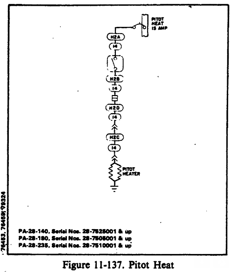

In trying to understand what is going on I dug into the internet and found a PA-28 service manual (don't know if this is the same model of pitot mast or not) which had this diagram
[img]cid:ii_jtzuqlmi2[/img]
which shows two resistors in parallel, although only one circuit supplying their current.
So, my deduction is I have two parallel resistors and two wires to feed them - the wires in the wing are 18AWG.
My room-temperature resistance readings may not be accurate (not 4-wire) or relevant (per Alec's comment about turn on at low temps) but doing a simple calculation I would have 14/2.9 = 5A and 14/3.7 = 4A for a total of 9A at room temp.
I can see that designing for 20A 12AWG (for the wires I'll be adding inside the fuselage) would give me a good margin. I wonder about the 18AWG wires in the wing though.

Pat, that is precisely the pitot mast that I have installed on my airplane except mine does not have the duct tape upgrade.
Thank you for the shot of the service manual and thanks so much everybody for all your help!
[img]https://mail.google.com/mail/?ui=2&ik=12ae5e93ee&attid=0.3&th=169de7bb9eae9ab9&view=fimg&rm=169de7bb9eae9ab9&sz=w1600-h1000&attbid=ANGjdJ8qmFLifUjSQRN4Y9L2EDeXRypIyZS5Yn-PpRaddydiO5wNIz1qrvhbQINjTDlQVYk3uxGiB8-vv9ewYdtiyq-Of9sRRL3OnXANrAR1am57cRU4Gl8OfBiaw3A&disp=emb&realattid=ii_jtzujnjo0&zw[/img]
[img]https://mail.google.com/mail/?ui=2&ik=12ae5e93ee&attid=0.1&th=169de7bb9eae9ab9&view=fimg&rm=169de7bb9eae9ab9&sz=w1600-h1000&attbid=ANGjdJ8iaa62WqooBfWf8kt00iC1b-Qqs4tM9vVIDLCsS884IxI2rTpOyIu1sd5yE6hJxUDVLpPDulk4XsG-vxXPcEqttJBk3aaR0J_c6qmtYS8eXd3vcl34KAUEZMk&disp=emb&realattid=ii_jtzuk28o1&zw[/img]
A to ground 2.9 Ohm
B to ground 3.7 Ohm
[img]https://mail.google.com/mail/?ui=2&ik=12ae5e93ee&attid=0.2&th=169de7bb9eae9ab9&view=fimg&rm=169de7bb9eae9ab9&sz=w1600-h1000&attbid=ANGjdJ9-2Y97fI4B5FjUnrTZrTDj4mNGUJmeQjqWcECfUENP53YyavRslhVMRoD8tVEwcTcsun60bC1LUc2tKeNG5IakuAt-re8yLjxiBRwzqo7x2ey0zEV2eQvp4Nw&disp=emb&realattid=ii_jtzuqlmi2&zw[/img]
[img]cid:ii_jtzujnjo0[/img]
A to ground 2.9 Ohm
B to ground 3.7 Ohm

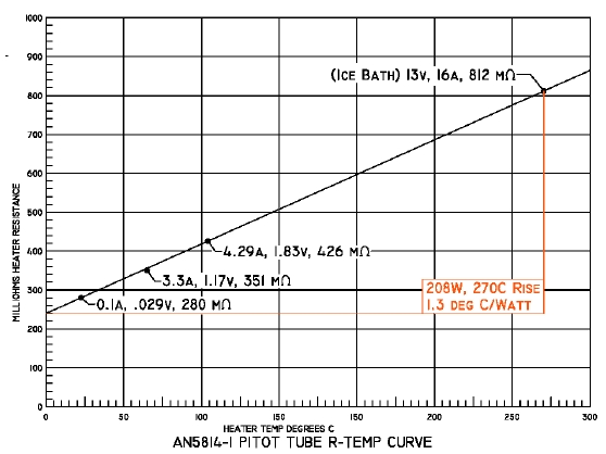

Sure. The document I cited speaks to
the heater temperature coefficient of
resistance for an exemplar pitot tube.
[img]cid:7.1.0.9.0.20190402132145.0606f2b0(at)aeroelectric.com.0[/img]
In the instance illustrated, resistance
will vary over a 4:1 range between 0C and
the 270C operation during a max-ice
condition. You can check your heater on
the bench but do it will the tube
submerged in water to avoid still-air,
room-temperature overheat. Without
the heat rejecting qualities of ram-
air in near-icing conditions, the tube
will easily heat up to cherry red!
The wires will be fine . . . tie them together
at some convenient point you can reach, then
extend on to switch with the 12AWG wire.
The drawing shows 15A breaker which is also
fine.
