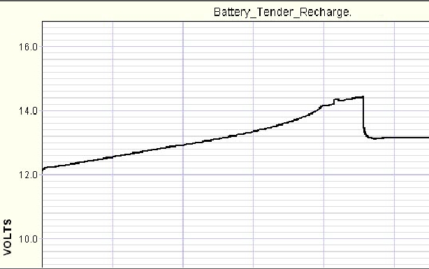

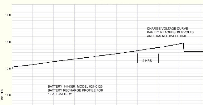

My maintainers always sat at about 13.1 to
13.4 volts after their run-up during
charge.
[img]cid:.0[/img]
[img]cid:.1[/img]

I continued to use my trusty constellation of
wall-warts with pleasing results.
