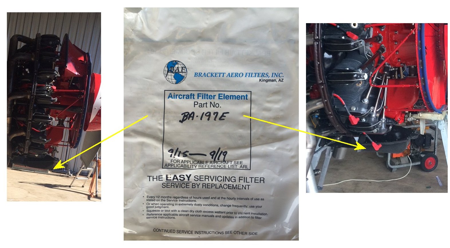

Try Brackett they produce a Carby inlet filter sock for the M14 as fitted on the CJ. Not sure if the 52 geometry is the same.
Brackett BA197-E

That doesn't look like it would work with the Yak airbox. I'd be curious to see if anyone has adapted anything for the Yak.
