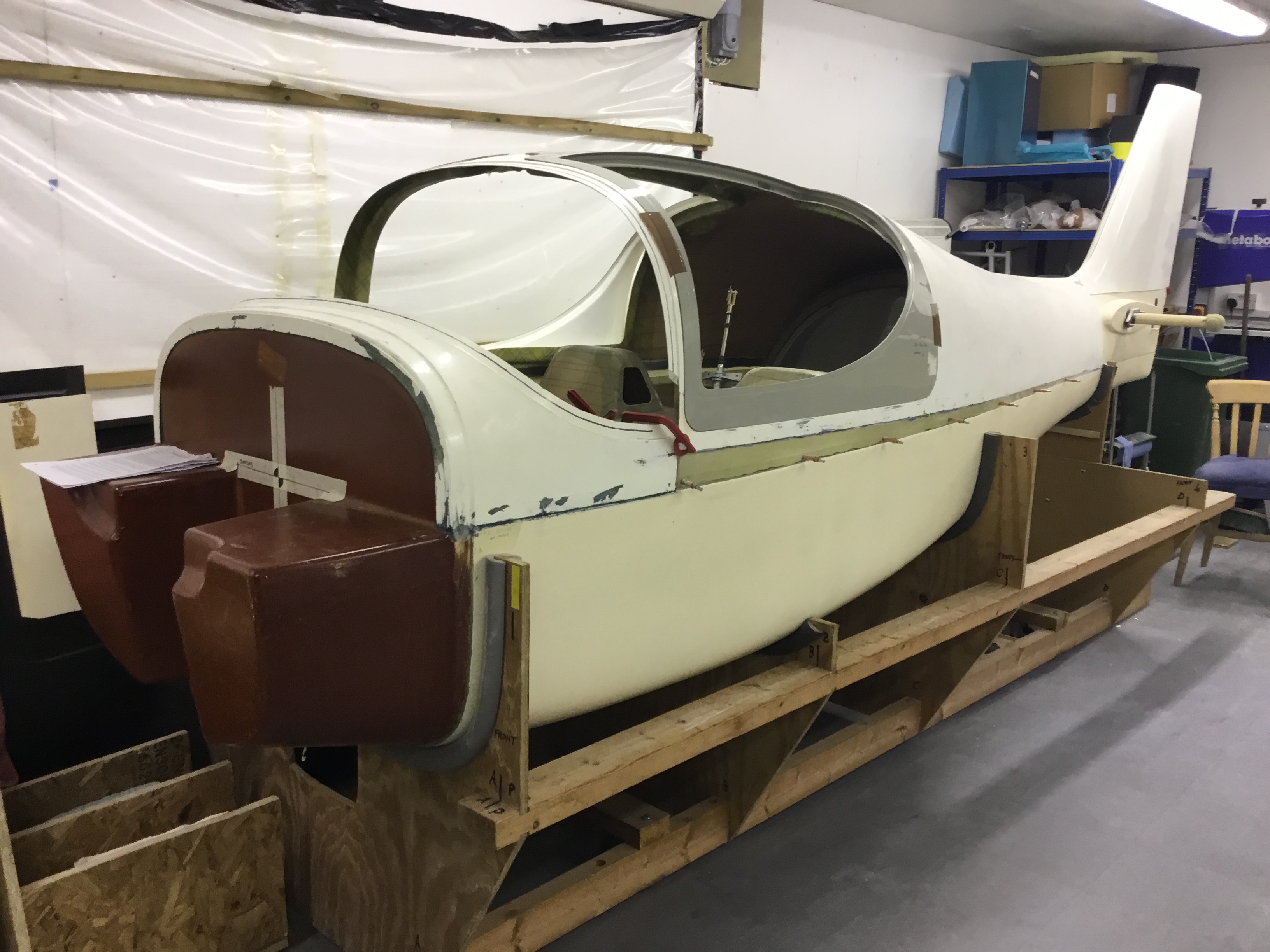

The Hi Top mod is achieved by jacking up the front of the fuselage top moulding and inserting wedges of reinforcement either side prior to bonding the top in place. You can see this on the attached picture of one I did earlier.
From this you can see that it is only realistically possible to do this during the build. From the phrasing of you post, I’m assuming that your top fuselage has already been bonded to the “canoe” (bottom moulding) – in which case your options are limited.
Hope that helps
Nigel
