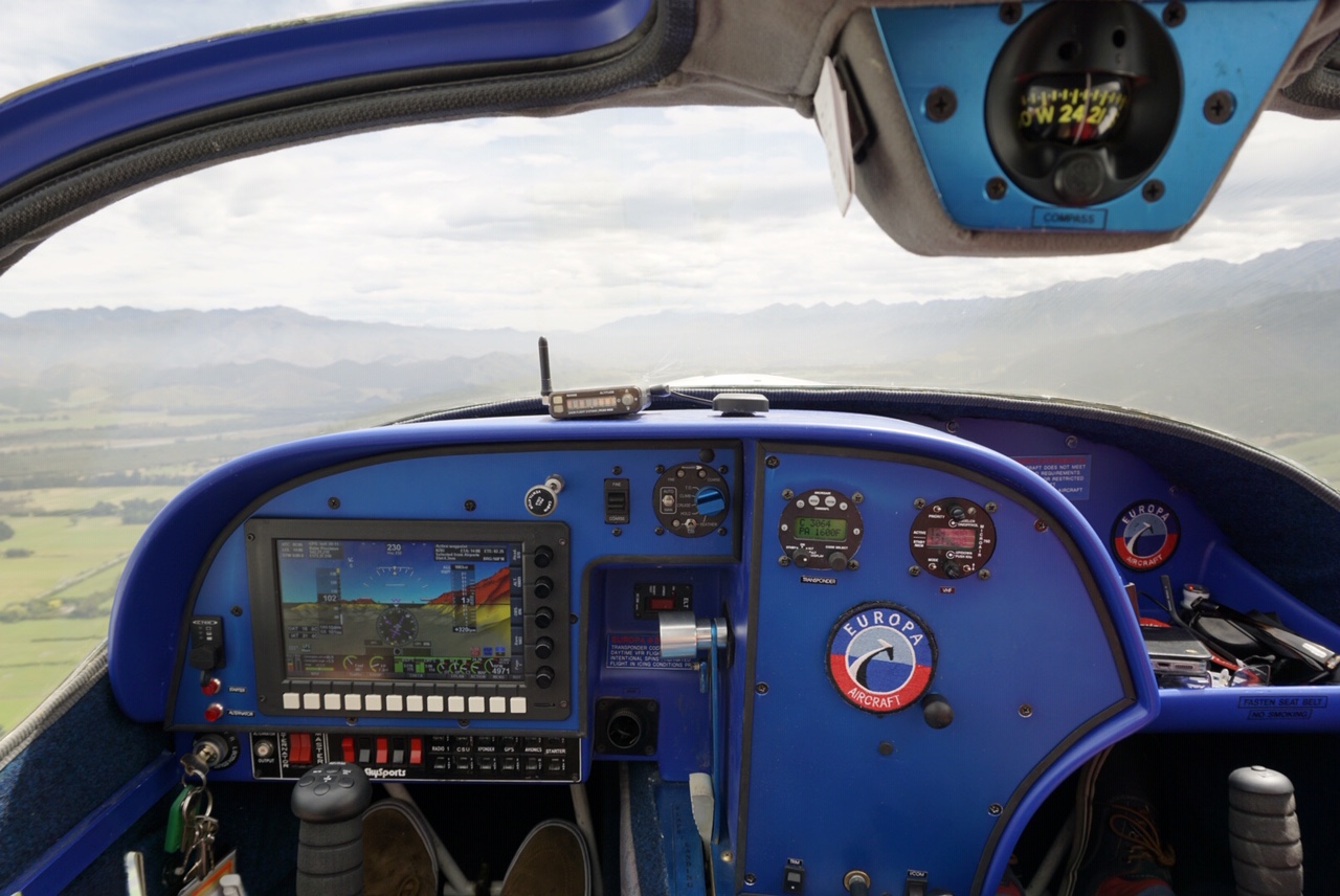

PostPosted: Tue Feb 19, 2019 2:15 pm    Post subject: a compass question Reply with quote
[img]cid:572B3767-7A89-4816-BC78-4498DFF1C6D3[/img]
Hi Fred,
I incorporated a compass ‘holder’ within the home made roof composite lining as seen in this photo. I designed it around a 747-400 compass moulding when bored flying over the Pacific years ago. I placed a blue aluminium plate to secure the compass.
Great position to read the compass with a compass swing card reading on the side.
However, I do believe obsolescence has crept in regarding a compass with all the other
direction finding instruments of today. We have to have one as an electrical failure is always a risk.
All the best,
Tim

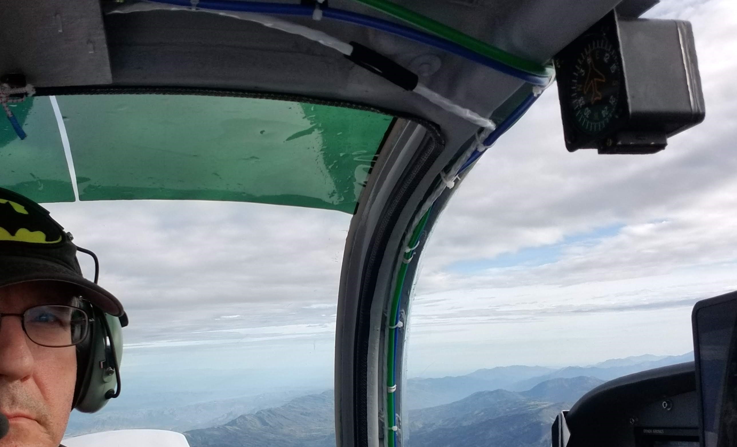

Fred
[img]cid:ii_jscbrq451[/img]
 stuck mine on the roof - I reckon that is what david recommends.  I assumed that it might be influenced by the electronics if I stuck it on top of the instrument module

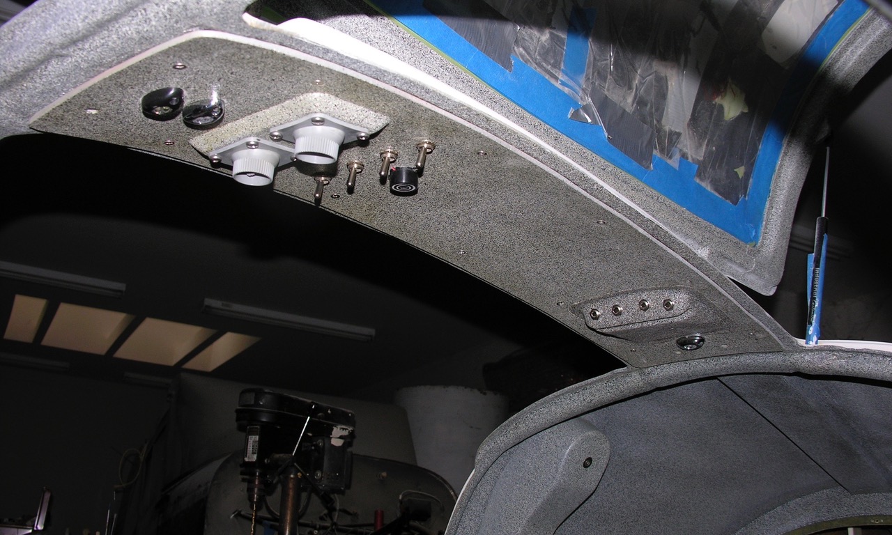

freddythek10(at)gmail.com
PostPosted: Tue Feb 19, 2019 4:41 pm    Post subject: a compass question Reply with quote
On Feb 19, 2019, at 2:14 PM, Tim Ward <ward.t(at)xtra.co.nz (ward.t(at)xtra.co.nz)> wrote:
Holy cow Tim…what an outstanding set up…thanks for the pix!…
BTW, I could not resist an allusion to “heavy iron� by incorporating a few toggles in the overhead.
[img]cid:667F3734-C3E3-4CF9-834B-65049EF4A079(at)Home[/img]
