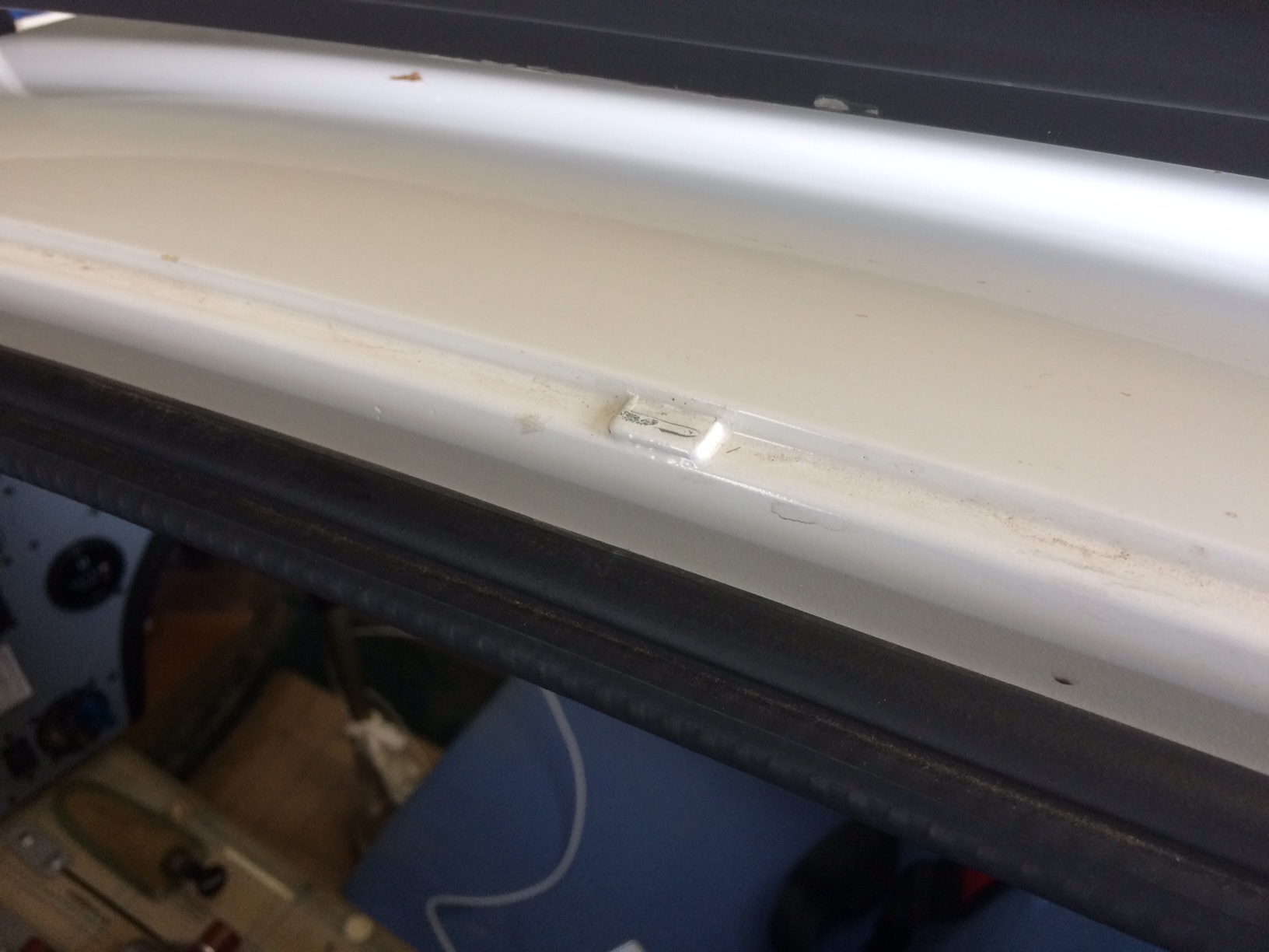

Regarding your door problem, I had this trouble when I fitted my doors
and found I was making very little progress trying to sand the edge of
the doors for clearance.  It suddenly dawned on me that a small spacer
placed midway between the hinges on top of the door surround should work
and to my delight it fixed the problem immediately.  The packing has to
be thick enough to ensure the surface of the top of the door is level
with the corresponding surface on the fuselage.  Try a piece of
cardboard with sticky tape first if you have any doubts about it working.
See photo attached.
Kingsley in Oz

PostPosted: Wed Feb 06, 2019 5:12 am    Post subject: Cold weather Reply with quote
Kingsley
thanks
What a good idea!
