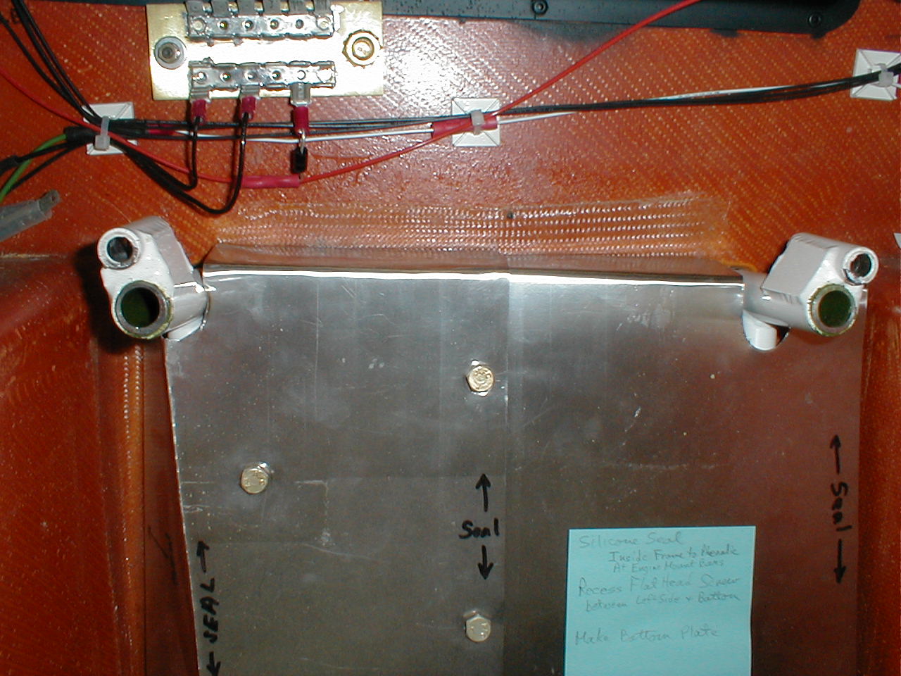

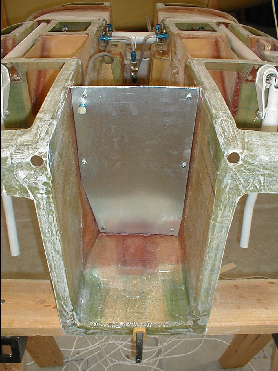

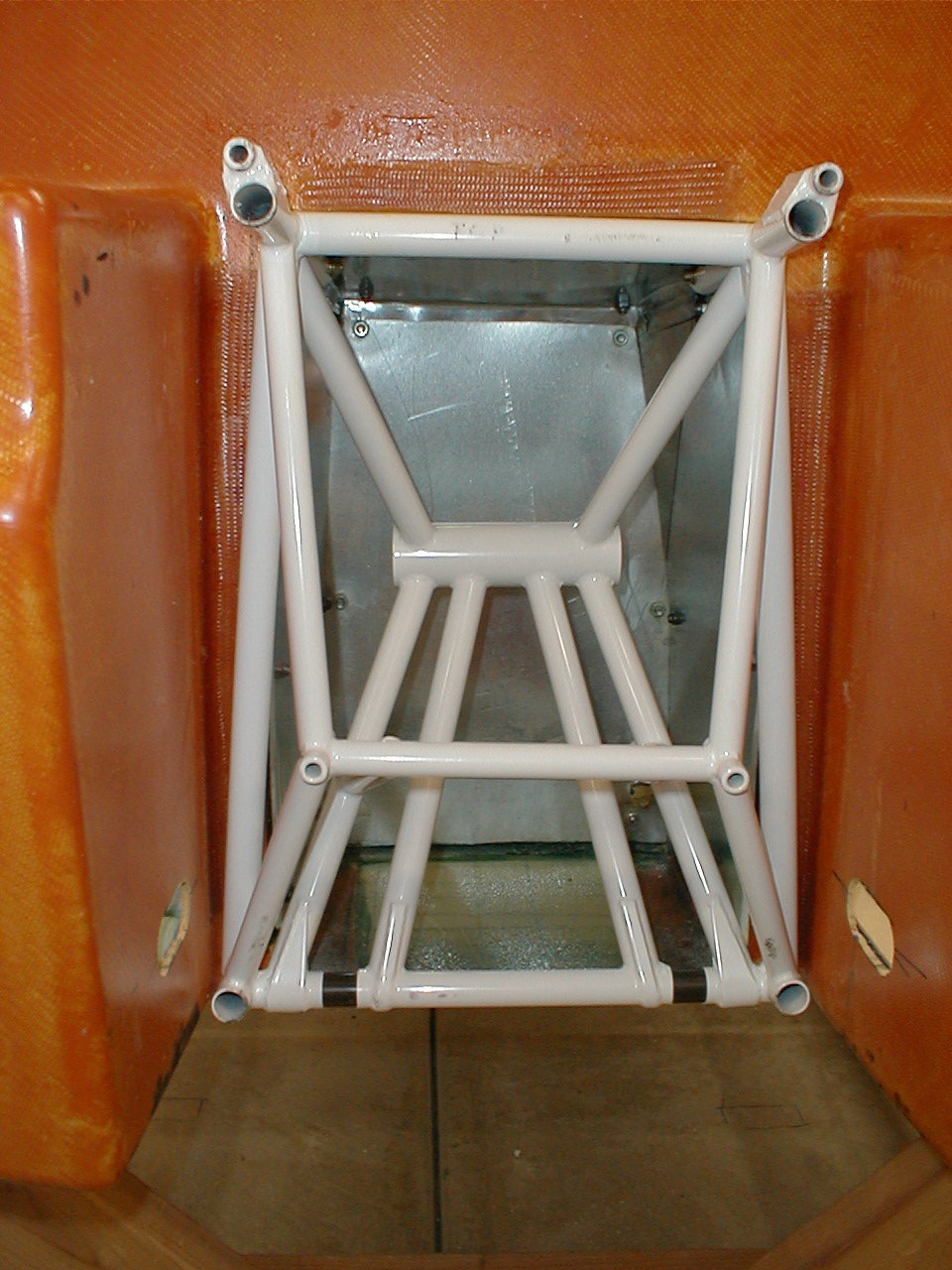

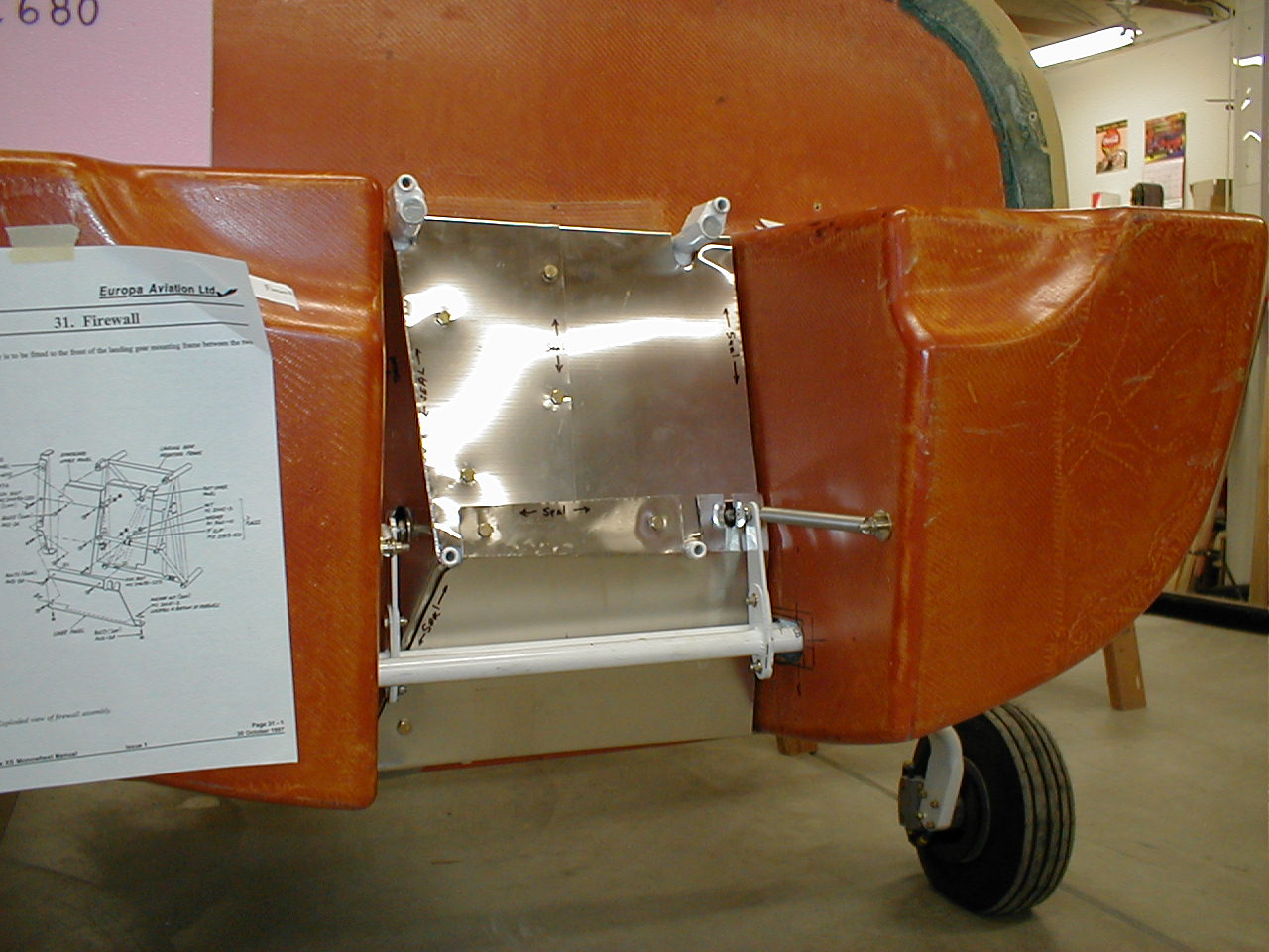

I covered the â€œinsideâ€� wheel well area with stainless. I did bend the corners for some overlap and filled in with the fire resistant chalk. I attached each of the four panels with a small spacer behind and AN bolts and nuts. I pulled a few pix from my build log. The first one shows the â€œoriginalâ€� style firewall. But this is designed for the monowheel. The second picture just barely shows how I decided to just cover the rear, top, and two sidewalls with stainless. The next pix was my first attempt to cover the rear wall, but my next iteration has the curved edges for a better seal. The next pix shows the Mod 72 inserts placed into the top engine mount joints. Notice they are missing from the second pix. With the latest concern of two Europas having found joint cracks in the lower joints (the joints in the second pix. lower crossbar, outside of the two dark bands, I have posed a question on the Forum as to whether a Mod 72 type fix would help in this issue. Have to wait for the powers that be to come back with answers. During the final assembly, after installing the lower cowl, I had to cut open the section below the landing gear frame to assist in the cooling. I even manufacturered (well Bud did) a duct between the oil cooler and the exhaust pipes and crafted a lower exit ramp to increase the airflow because of the Jabiru’s tendency to get too hot. The last pix just shows the ramp under the lower cowl.

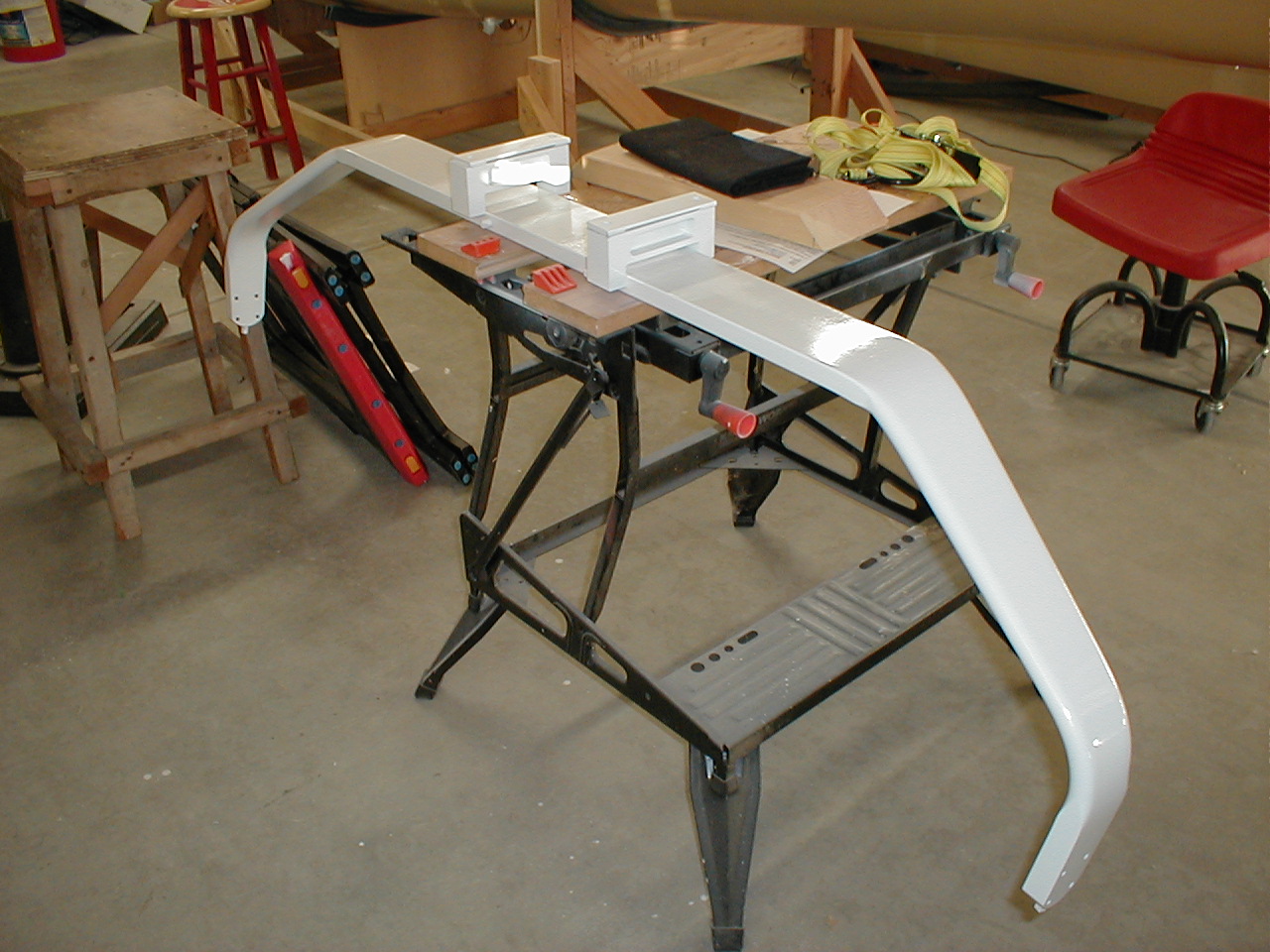

Was wondering which gear legs you went with? I used Bob Berube’s style as shown in the next pix.
