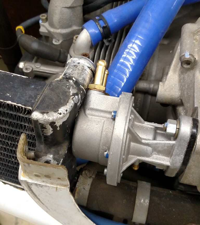

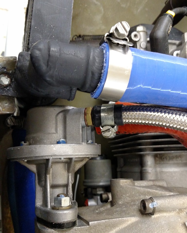

I had the same issue with the new fuel pump. I took Creighton Smith’s Radiator to my welder and moved the hose fitting to clear.
New fuel pump interference:
Looking back that was the easiest/cheapest fix since research gave me no other options at the time. The fuel pumps I could modify with were $360 US and the welding was $50 (see below).

Hi Bud
Interesting.  Even with the moved rad pipe that is very close!
I was hoping some one would know of a compatible replacement. Will investigate your suggestions although I have kindly been supplied with an original pump here in the UK.
[cid:part1.AC4CDF6E.DDDAED84(at)lawless.info]
[cid:part2.EABDE25A.447D636F(at)lawless.info]
