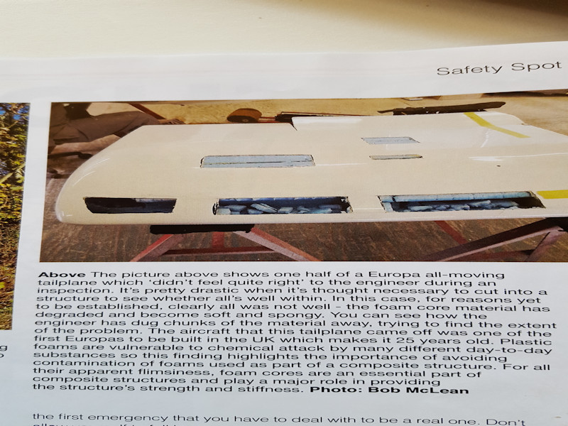

Not sure what to make of the pic page 49 of the LAA mag Jan 2019, showing a tailplane with the skin removed in 6 big rectangles completely trashing it and saying that something has made the foam go soft and spongy.
Lots of that foam around uncared for and its still as it ever was. It mentions contamination but how on the leading edge? I think I would have explored some other ways like small holes and expanding foam.
I guess the only way in is via the tube and something ominous has been used to clean/lubricate it and its run down the inside to the leading edge. Maybe it was condensation/water logging then ice?

Holy-moly!  what could have happened there?  Protected from sunlight, the blue foam does not degrade without some reacting chemical involved (like acetone etc).

My first impression of the photo is that its possible someone cleaned the grease of the bearing tubes with gasolene or avgas, that would dissolve the blue foam.
There would be evidence for that in the form of a blue “lacquering” effect of the dissclved styorofoam. The solvent would not evaporate quickly because its
almost fully enclosed. It would hang around and do a lot more damage.
