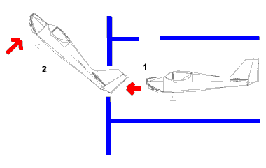

gilles.thesee(at)free.fr
PostPosted: Thu Dec 20, 2018 8:18 am    Post subject: Building: Fitting the fuselage through the window? Reply with quote
Hi Simon,
It is not huge on the inside (4,65m x 5,01m). But without cowling it
should barely fit. There is a second room that belongs to it (2m x
5.18m) to store smaller parts or the wings etc. The ceiling is at ca.
3.30m. I may be able to store parts underneath it when not working on it.
Rooms seem most adequate.
A 3.30 m ceiling is quite interesting.
It's a mono wheel. I could imagine that it could even fit with the main
wheel installed.
Maybe you'll be better off with setting up wheels etc. inside, then removing them to save weight for the delicate maneuver ?
I remeasured the window. It is actually a bit larger
than initially thought. 1,40m x 1,40m.
At first thought, the idea would be to turn the fuselage on it's side, then somehow "thread" the fuselage through the aperture :
[img]cid:part1.C185672A.A456B807(at)free.fr[/img]
All the best,
Kind regards,
Gilles
http://contrails.free.fr
http://lapierre.skunkworks.free.fr

Hi all and thanks for the helpful hints and especially for pointing out the importance of the alignment part and the part on insurance. I have to admit, I didn't think about that. It would make sense to contact a few insurers to get an idea about the difference in premiums.
The kit came with Hi-Top Mod-64 (non-B) mod. However, I'm not sold yet on incorporating it. I would add complexity during the build. I am not tiny but also no basketball player (1.82m or 5ft 11.7in).
I will try to answer all the question in a single message:
[img]cid:part1.C4498FC2.AA04CC73(at)4lists.simonliebold.de[/img]
Thanks Gilles, I like your drawing.

PostPosted: Fri Dec 21, 2018 6:02 am    Post subject: Building: Fitting the fuselage through the window? Reply with quote
FWIW wrt headroom, I am 6' (and shrinking lol), but with a 6'2" seat height, so always have difficulty with headroom in every plane I sit in.
On my kit, I am cutting and lowering the cockpit module seat wedge (I have Andy's approval from way back when)  as far as possible (still accommodating the glider brake control etc), which puts me in a more prone position and gives me the required headroom without ugly bubble windows, or RV-12 looking hi-top pudginess Wink.  The stock fuse shape is just so sweet and efficient.  To make up for my loss of legroom, I am removing the panels bottom "switch" ledge..... lots of panel room these days when going all-glass.
an aside: I am still amazed how Richard V, ripped off the Europa design elements and threw them together into the slow and dorky pop-rivet RV12.
Cheers and good luck!
Pete
[img]cid:167d101c2eb110c5b3d1[/img]
