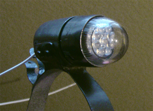

24-volt single LED bayonet base bulbs & 24-volts LED cluster bulbs
Superbight LEDs makes/imports these. They are normally for recreational vehicle use.
The single LED bulbs come in multiple colors and are drop-in replacements.
White = BA9SF-W-28V Red = BA9SF-R-28V Green = BA9SF-G-28V
There are used for the cockpit gear indicators, low fuel lights, generator/alternator light, etc.
The cluster bulbs are drop-in replacements for the external landing gear lights. Attached is an image.
Here is a link to their website. The navigation is not intuitive, but eventually you can find what you need.
https://www.superbrightleds.com

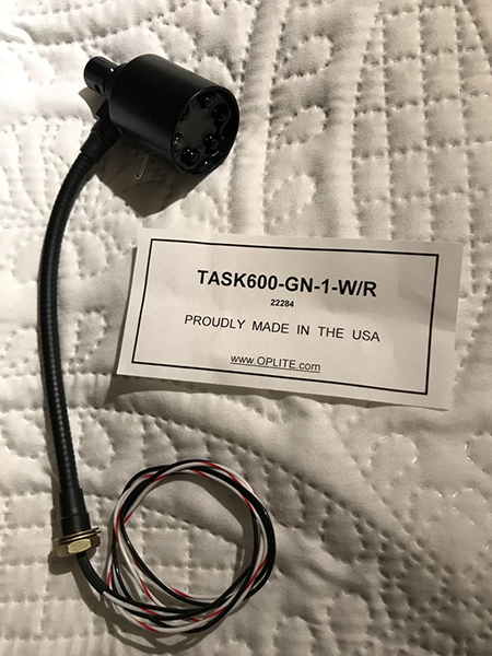

Cockpit map lights
To replace those dim, fluorescent Chinese cockpit map lights, I installed a flexible 28-volts OPLIGHT. A dimmer controls the brightness and also switches from white to red light. One of these generates plenty of light to view the entire instrument panel for night flying.
www.OPLIGHT.com These can be found on Amazon.com and sometimes on e-bay.com
