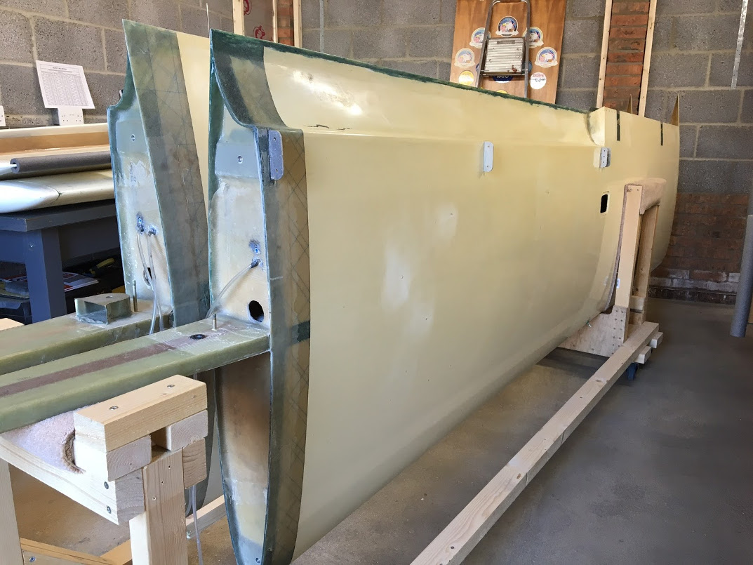

clivesutton
Joined: 23 Jan 2013
Posts: 187
Location: KENILWORTH
PostPosted: Mon Dec 10, 2018 1:23 am    Post subject: Re: Wing storage Reply with quote
Hello Eion,
If it helps, my solution is shown in the attached pic
Both supports are on 4 castors and on each, one wing cut-out is deeper than the other enabling storage with both spars together or opposed to aid of the available storage space. The two supports can be 'ganged' together with the horizontal strips of wood - to improve the ease of rolling the whole lot around, but i rarely find that extra precaution to be necessary.
The wing-shaped cutouts are deliberately inclined towards each other (upper surfaces face each other) to aid stability when stood outside unattended in a light breeze e.g. whilst you are waiting to put them onto or off of, a trailer.
Clive
 Filesize:  1.15 MB
 Viewed:  10300 Time(s)
eoinmaguire(at)hotmail.co
PostPosted: Mon Dec 10, 2018 5:52 am    Post subject: Wing storage Reply with quote
Hi Clive
Looks great, I’ve got a few great options so far!
Eoin
On 10 Dec 2018, at 09:26, clivesutton <clive.maf(at)googlemail.com> wrote:
Hello Eion,
Clive

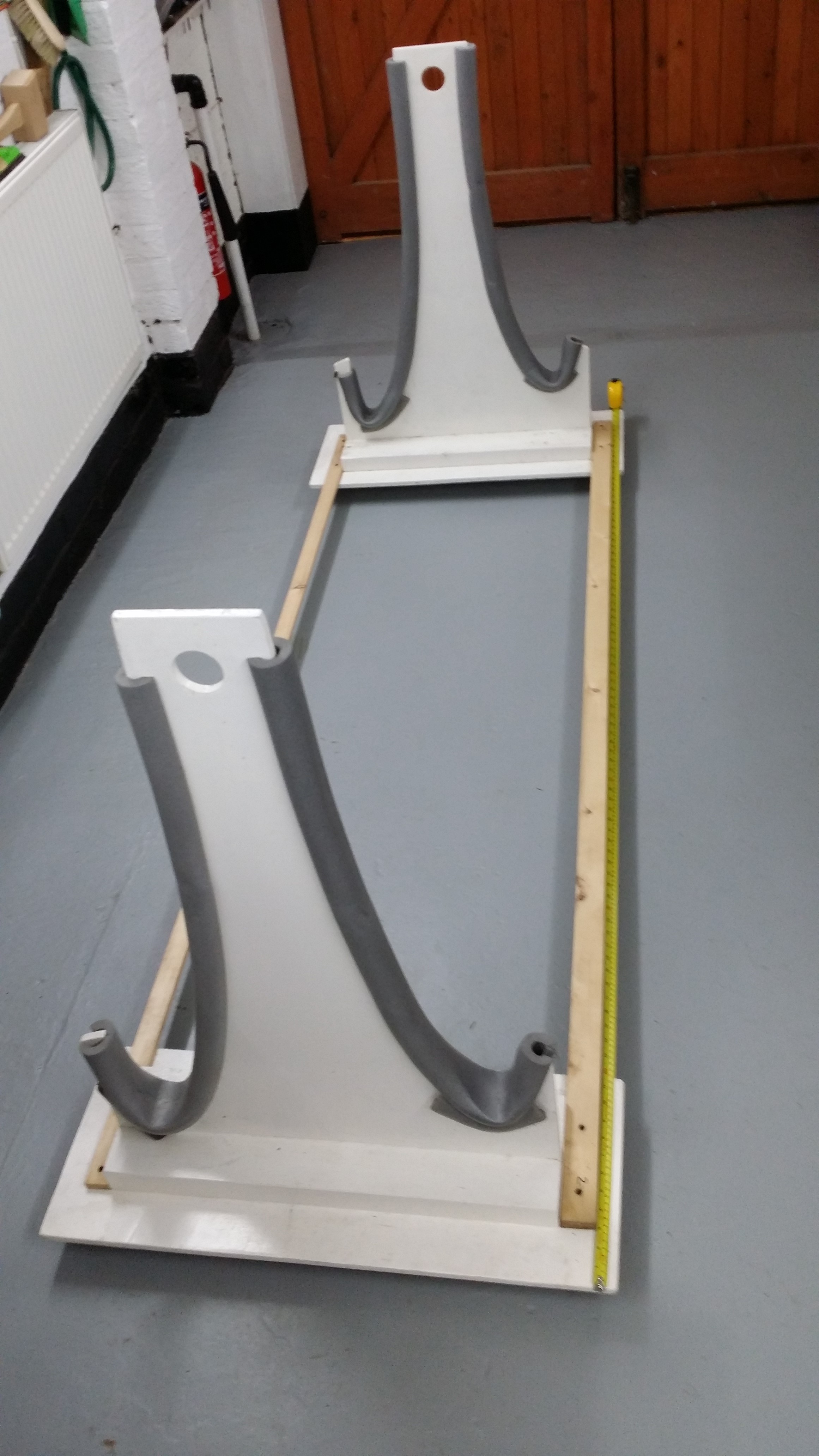

sim(at)4lists.simonliebol
PostPosted: Mon Dec 10, 2018 6:22 am    Post subject: Wing storage Reply with quote
Another solution attached. Not as nice but it works. I didn't build the
stands.
Simon
 Filesize:  194.71 KB
 Viewed:  10282 Time(s)
flyingphil2
Joined: 04 Dec 2009
Posts: 117
PostPosted: Tue Dec 11, 2018 3:34 am    Post subject: Re: Wing storage Reply with quote
I recognise those wing stands Simon.
Yes, they are functional but I think Clive's are far more elegant.
Hope your build is going well Smile
PostPosted: Thu Dec 13, 2018 5:27 am    Post subject: Wing storage Reply with quote
Hi Phil,
Smile They are simple and fit their intended purpose.
I may finally have found a workshop within walking distance from home. I
will contact you directly regarding those wings.
Simon
