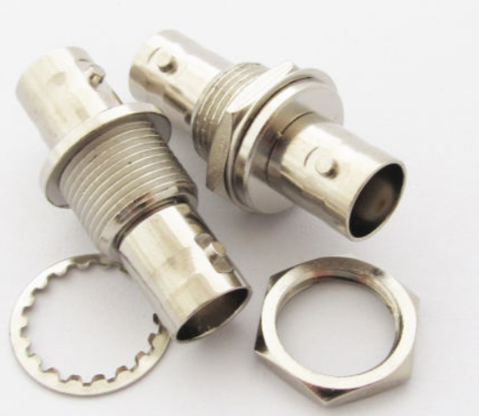

PostPosted: Tue Nov 13, 2018 6:01 am    Post subject: Antenna position Reply with quote
At 03:42 PM 11/12/2018, you wrote:
The antenna is a one-holer, Bob.
Bill
'one holers' tend to put stronger
flexing moments at the mounting
surface . . . but this isn't a
200 mph airplane either.
have you gathered any lessons-learned
from the Excalibur community?
I've often pondered the notion of
trying a 'rubber duck' antenna
off a hand-held for applications
like this. I suspect the range
will not be seriously compromised
while mechanical stresses at
the base would be minimized.
Mechanical and electrical attachment
would be achieved with a feed-thru
connector
[img]cid:7.1.0.9.0.20181113075228.067e3278(at)aeroelectric.com.0[/img]
Hmmm . . . just some random thoughts
early in the morning . . . might find
a hole in the logic after a few more
cups of coffee!
