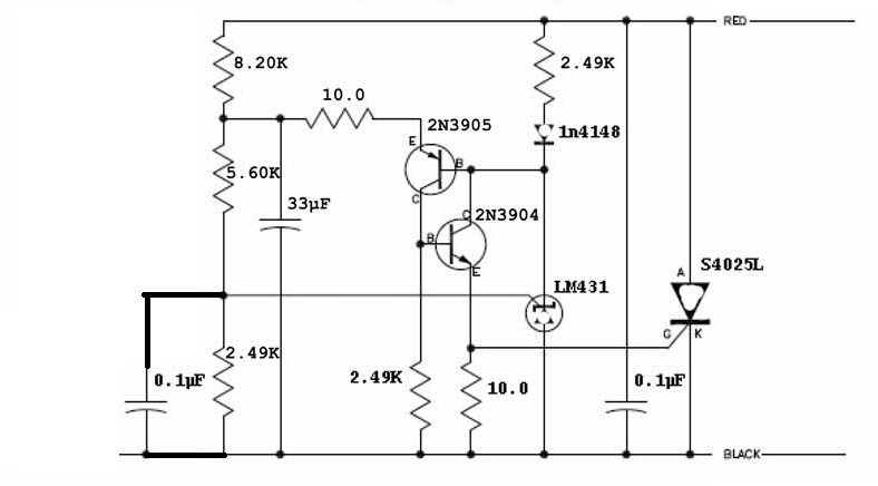

Bob,
I added a 0.1 MFD capacitor across the 2K49 resistor in the lower left corner. This has resulted in much improved stability and consistent operation.
