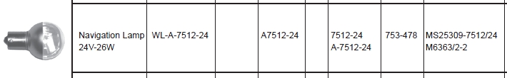

Talking about tracing CRAZY electrical issues. TWICE, I have come
across bulbs that check good on continuity yet DO NOT LIGHT!
No, it was not corrosion, not this time. Care to take a SWAG at it?
I would bet the airport that no one would guess.The failed bulbs were Marker Nav Light Bulbs. hint, hint.
On a 12 VDC system the bulbs are reaally a 24 VDC bulb.
And on a 24 VDC system, yes you guessed it, they are really
a 48 VDC BULB. It is done that way to extend the life of
the bulb.

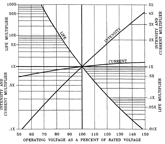

Where is this idea published? In chapter 12 of the
'Connection I speak to the relationship between
applied voltage and life/current/intensity of
the typical incandescent bulb.
[img]cid:.0[/img]
For every ~5% reduction in voltage from the
bulb's design center, life approximately doubles.
So in your hypothetical 50% drop from design
center, bulb life goes up HUNDREDS of times.
At the same time, light output drops to about
10% of the design center . . . and in fact
is quite redish in color.
[img]cid:.1[/img]
An exemplar navigation lamp is in the 21-26watt class
and operates at a color temperature strongly suggesting
a design optimized for light output/color . . . and NOT
de rated for service life.

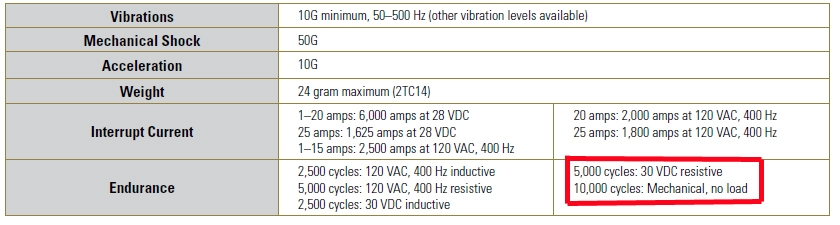

And YES, I think crowbar circuits can be kinda' tough on alternator field circuit breakers and could cause eventual degradation; especially after a long series of false trips. Brings to mind a U.L. report of a homeowner who habitually 'tested' his residential circuit breakers using a screwdriver. As you might suspect, the outcome was not good.
Can't speak to breakers in a home but typical
breakers popular in aircraft are qualified to some
pretty robust requirements not the least of which is
endurance. Here's an exemplar call-out for a Klixon
product.
[img]cid:.0[/img]
http://aeroelectric.com/Pictures/Breakers/Klixon_1.jpg
When I first proposed the crowbar shutdown method for alternators
in aircraft, the idea was driven by a Beech procurement spec
that called for any offering of an ov 'relay' be tested under
worst case conditions and withstand 50 simulated ov events
on a test stand.
Reasonably priced relays at that time were hard pressed to open
the field on a 100A, 28v alternator in full-bore runaway
50 times in a row.

Ability of the system to withstand repeated trips was
not limited by anything I was supplying . . . but by
the ability of the circuit breaker to shoulder the stresses.
A breaker with stellar qualification numbers.
Note: not ALL breakers are so qualified. Here's one
example . . .
http://aeroelectric.com/Pictures/Breakers/Breaker_Failure_1a.jpg
Short answer is that crowbar trips are a 'walk in the
park' for the field supply breaker.
