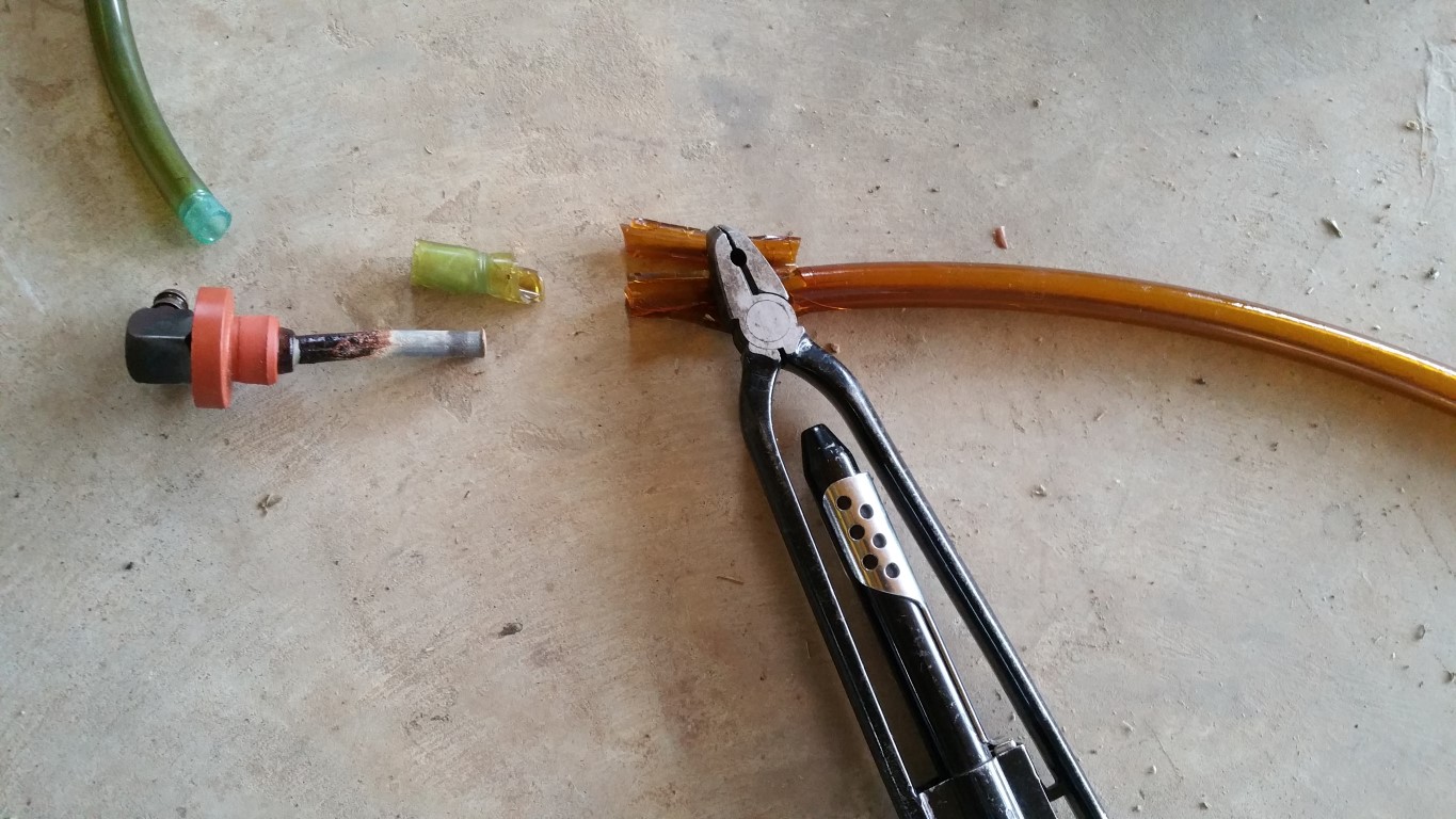

Well, after a year of distractions, I got back on the Kolb this afternoon, hoping to get it flying for our annual Pumpkin Drop here at Slobovia Outernational (MS71). It's been sitting for about 11 months, with the fuel I put in it last year. Non-ethanol premium mogas is what I put in it. I decided to drain the tank to add fresh fuel, so I added some line to the fuel output line (to reach a gas can) and blew into it to pressurize the tank & start fuel flowing. Got great pressure with one lung of air, but only air came back out the line. Finally pulled the fitting (installed in the top of the tank) and it came out with about an inch of the urethane flex line I used to reach the bottom of the tank, with a pickup filter on the other end. You can see in the pic what the pickup line looks like. Strange thing is, the lines on the outside of the tank are in good shape, even though they came off the same roll of fuel line and still have fuel in them.
I guess I'll replace with some teflon lined a/c grade stainless flex line. I must say, I'm a bit surprised that it would rot this badly, this quickly. I thought annual replacement was a precaution; not a "I hope I get this before I die" kind of thing.

I don't know why folks insist on using plastic fuel line.  It's an ultralight thing I guess.  Stuff is dangerous.  Some that use urethane fuel line say they need it so they can see the fuel?????
Way back in prehistoric days of my ultralighting, I automatically used urethane because that's what came in the kits and everyone else was using it.
After some problems I changed over to neoprene rubber fuel line many years ago.  Never had a problem with it.  Last for a very long time.  It has been around for a very long time.    But I can't see my fuel......

Hello John. Do you use the reinforced neoprene or just the straight neoprene like Aircraft Spruce sells? Thanks, George George H.

I buy the fuel line local, a good grade with pretty stiff wall.
I like Gates.  Go to their site.  They have a lot of new stuff.  Was just looking at submersible fuel line for using inside the fuel tank.  Most neoprene rubber fuel line is fuel resistant on the inside, but not on the outside.  Submersible is resistant inside and out.

Well, shucks. The fuel line image didn't make it through. Let's try again.
Has anyone used any type of 'plastic' fuel line other than the blue urethane stuff? What about other materials? Vinyl? Tygon?

   I buy gates when I can find it locally..otherwise just std auto fuel line.. Very shocking to grab the yellow stuff and have it disintegrate in ones hand..!

I have reverted to quality automotive hose, Gates.  The plastic hoses have failed prematurely on my Kolb just  unreliable.

Thanks to all for the replies. I sent the 2nd post before noticing that John and others had recommended automotive hose. I'll order some submersible hose & hopefully, be done with this issue.
From: owner-kolb-list-server(at)matronics.com [mailto:owner-kolb-list-server(at)matronics.com] On Behalf Of George Helton
Sent: Friday, October 19, 2018 7:34 PM
Subject: Re: urethane fuel (??) line
George H.
Firestar
Mesick, Michigan
gdhelton(at)gmail.com (gdhelton(at)gmail.com)
On Oct 19, 2018, at 8:19 PM, John Hauck <jhauck(at)elmore.rr.com (jhauck(at)elmore.rr.com)> wrote:
From: owner-kolb-list-server(at)matronics.com (owner-kolb-list-server(at)matronics.com) [mailto:owner-kolb-list-server(at)matronics.com (owner-kolb-list-server(at)matronics.com)] On Behalf Of Charlie England
Sent: Friday, October 19, 2018 5:42 PM
Subject: urethane fuel (??) line
BTW, if you're within striking distance of Jackson MS, come on down for the Pumpkin Drop. Contact info on the flier attached.
