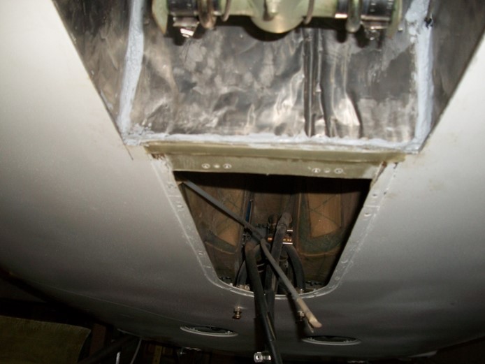

Most of my photos are in archive with the client files and are with them.
For a trigear conversion you can see that the belly hole was filled in with a flange on the inside, and then a recessed plate installed for a clean finish.
The hole I make in the tunnel area for access normally measures 6 inches wide by 8-10 inches long.
If the belly pan is stock, it is a very thin two to three layer panel on the belly and over time is no longer straight and smooth. I cut the hole, and build up the inside to fit my flush panel (normally .063 aluminum, or FRP or 1/8 ply) and glass it in from the inside. If the tunnel is sealed and work inside is impossible, I cut the access hole and make an exact copy and then cut the inside out (making a ring) for access to allow proper but tedious glassing of the flange.
On others for expediencies sake, I have just put a plate on the inside hollowed out as a flange, reduxed that ring to the inside and riveted it in to get a good bond. Then I fitted a plate for the outside to match the skin cut out to avoid the glassing. Install nutplates and used 525 screws to hold it in. The outer sheet metal cover is of .025 6061 aluminum and rests roughly even with the belly skin cut out. This is easy but what a bear to try not to cut into his wires laying all over the place in the belly. Much work with a flashlight and borescope to cut an initial round hole to prevent whacking his brake, fuel and wiring into shreds. We then tacked up his brake lines, repaired his brakes, and reran his wires. Get a creeper to lay on with a body lift or develop very strong stomach muscles.

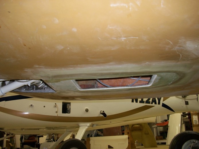

Here is a photo of one a client did on his trigear conversion. He just left the old hole in place. After seening how I did my belly access, he installed his new firewall about 1.5 inches behind the nose gear frame where we put in a ply and glass firewall and covered with A/C Spruce firewall material (excellent stuff).
This access to the tunnel made the process of conversion of the tunnel quite comfortable.
Transformation of the mono to trigear tunnel is a piece of cake. Glassing and finishing was tolerable. I normally like the access hole to be a little further aft of the firewall to allow for the Fascet fuel pump to be moved where it is easier to service in the tunnel as shown in the second photo.
The belly hole allows for access to the brakes wiring, fuel selector, and wiring. Annual flashlight inspections are a breeze.
Hope that answers your questions. Don’t over think it, just do it.

Hi Bud, thanks for your suggestions as always.

Where do you have that large panel, is it approximately where the landing gear is mounted, and and do you have a picture that you can share? (I could not find any picture on your website)

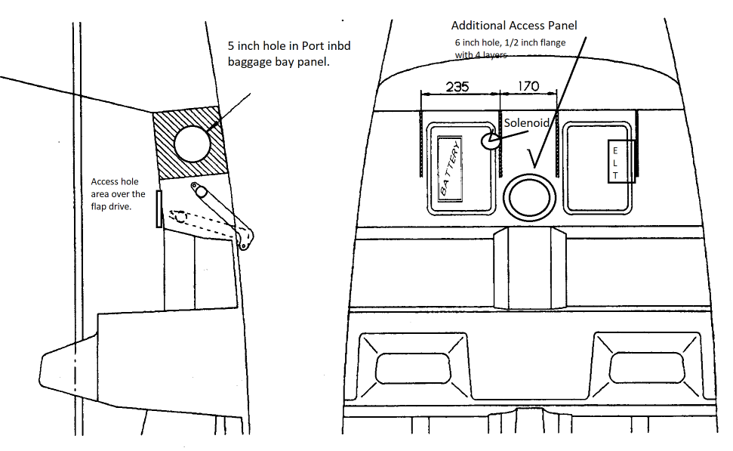

PostPosted: Sun Oct 07, 2018 11:34 am    Post subject: Advise wanted: route new wire bundle through tunnel Reply with quote
Marcel,
I did not put an access from below, to access the baggage bay. I put the access hole in the floor between the panels, so I can access the flap drive, and any wire bundles I need to run through the tunnel. I can use a large mirror to see and inspect well forward.
Under the fuel tank I have the stock access holes. All my customers have the elongated hole for access. Between that fuel access hole, the one in the baggage bay floor, the aft end between the seats from on top, and finally the large hole in my center tunnel makes the plane quite enjoyable to inspect and service.
There is nothing wrong with opening up the hump in the tunnel aft of the Mod 52 bar if you need to gain access. Just glass it back up or put in a flange and restore the structure for your trigear frames. I elected to simply put the hole (six inch hole with a ½ inch flange allowing 5 inches of round hole to see in there) in the floor and it allows easy access to my flap drive.  I also made a large hole through the vertical support on the inboard port vertical support also to allow service.
See drawing of my typical baggage bay.
If I can put an access hole somewhere to allow maintenance and retain structure, I do it.

My baggage bay arrangement is pretty much the same as in your standard layout, except that I do not have that 6 inch access hole with 5 inch access on the floor of the baggage bay.
That extra hole would make things a whole lot simpler (now and for future work and inspections), so that's what I will be going for. For the job at hand I think this will resolve my current issues/concerns.
