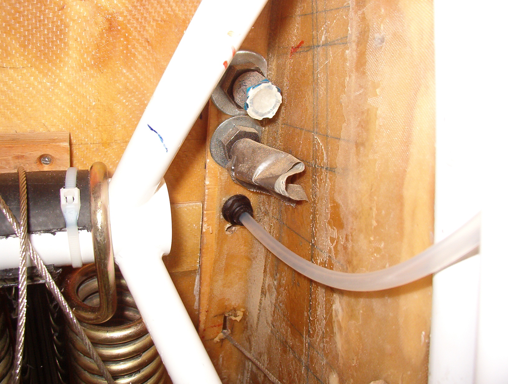

PostPosted: Sun Sep 30, 2018 7:35 am    Post subject: Re: Noseleg bungee/spring replacement Reply with quote
During my build I installed a half hose to the top and bottom area to hold the spring in place and Tye wrapped it in place. It has worked for the last seven years and 190 hours.
