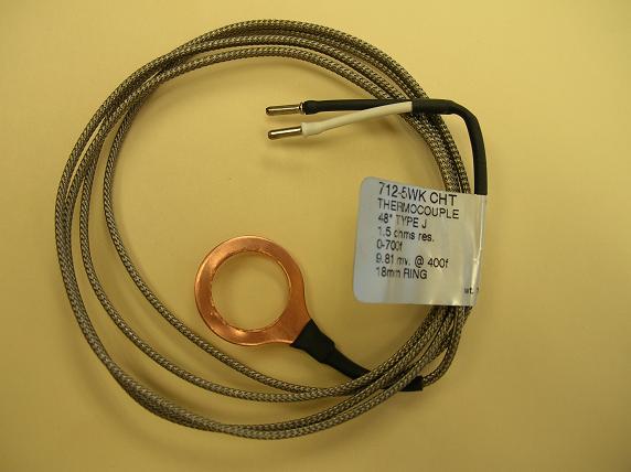

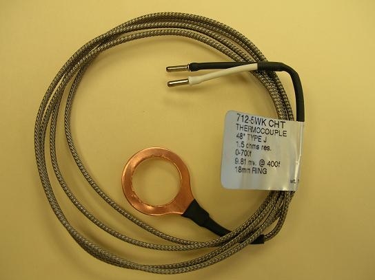

I am wiring some of these CHT probes to a Dynon Skyview
[img]cid:ii_jm0opve90_165d3639cd62b9f2[/img]
I'm hoping to connect them with these
https://buy-ei.com/portfolio/olc-1/
as recommended by Dynon but as you can see the probes come with bullet connectors. I don't have any female connectors for the bullets. Will it mess up the readings to cut the bullet connectors off, strip the wire, and connect them to the Dynon harness using the OLC-1s?
Thank you,
Sebastien

Sebastien:
Not at all!  You just have to figure out the polarity.  Voltage output should be something like 23 microvolts per Deg F.
BUT!  Why do you want to use an Under The Spark Plug sensor?  In general:
1 - They read High.
2 - They are very slow in reacting.
3 - They break easy.
Your choice of wire connector is a good one.  I have done dozens & dozens of connections using that connector.  WAY easier to use them than the nut & bolt system from JPI.

Looks good. The cool thing about modern thermocouple
sensor/indicator systems is the very low currents
flowing in the thermocouple 'loop'. Back when
thermocouples were used to POWER an instrument
on the panel, the voltages were small but the
currents significant . . . loop resistance had
to be kept LOW and FIXED. Thermocouple wiring
was rather fat. Long runs to measure CHT, EGT
or oil TEMP on the outboard engines of something
like the B29 might have been 18 or even 16AWG.

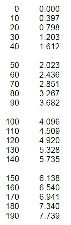

This was because thermocouples like Type K . . .
[img]cid:.1[/img]
Generated only 7.7 MILLIVOLTS off reference
at 190 degrees-C. Your error budget for voltage
drop in wiring was exceedingly small!
Nowadays, the panel mounted instruments are capable
of resolving the 400 or so microvolt difference
between 180 and 190C with a very high input impedance
to the instrument. No need to maintain
very low resistance pathways in the thermocouple
loops You only need to manage parasitic
couples.
The OLC-1 brings like-metals in the T/C loop direcly
in contact with each other . . . no parasitic couples.
So while the OLC-1 splices would be frowned upon
to join wires in a power feeder with significant
current, potential for upsetting the accuracy
in a modern thermocouple instrumentation loop is nil.
Could you post a product link to the CHT probes/terminals please? (I only get the list daily digest and guess you posted an image - I'll change my subscription type in a moment).
Also; I read Bob's article on DIY CHT probes, but still have a few questions - hope the group don't mind overloading a thread:
So far I ordered some AMP / TE 328975 12 mm ring terminals PIDG R 22-16COMM 22-18MIL 1/2 (http://www.te.com/usa-en/product-328975.html) for the job - with a view to removing the Plastic Insulation prior to installing - but:
- wonder if the above terminals may be too thin compared to the following thicker, plain-copper ring terminals: (https://www.parts4aircraft.com/cht-probes-ring-type-c2x9382903) - leading to premature failure or exhaust gas blow-by?
- wonder if the tin plate on PIDG terminals is not ideal, due to max working temp of tinplate being 150ºC typically. Will it burn/evaporate off and all be ok, or should I anneal the terminals to cherry red prior fitting, much as a spark plug copper gasket would be?

Sebastien:
1 - They read High.
Barry
On Thu, Sep 13, 2018 at 10:54 AM Sebastien <cluros(at)gmail.com (cluros(at)gmail.com)> wrote:
<712-5WK.jpg>
Thank you,
Sebastien
