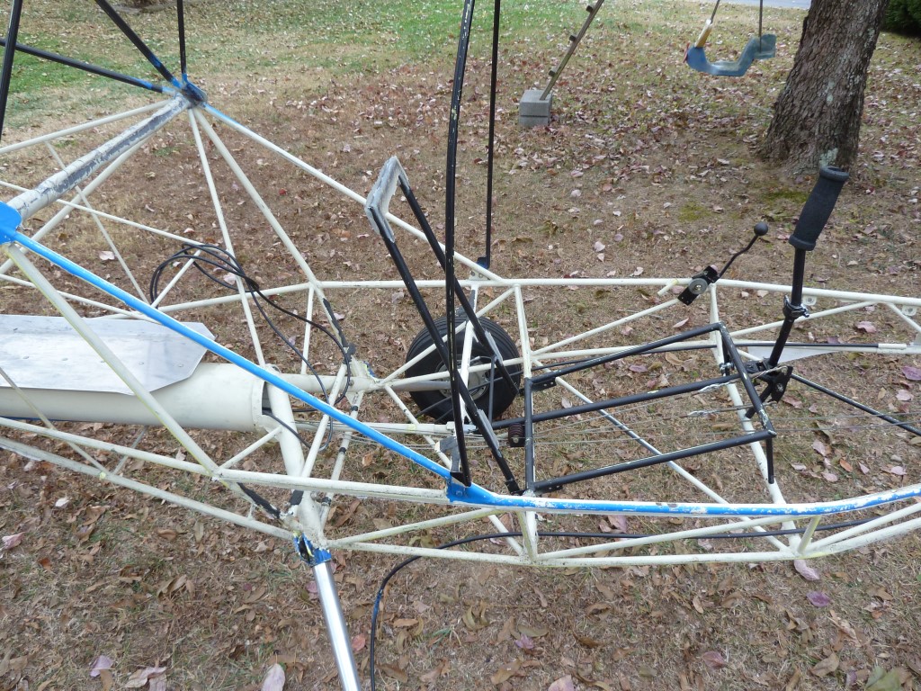

I suspect that the cages are different between the single seat FS and the FSII. But ~ I really don't know. So this:
First picture is a FSII cage with the pilot seat back in place; behind it is the space where the passenger seat normally goes. The front lower crossbar/seat attach point is the backrest brace for the pilot seat back. You can see the black seatback tube is up against the white horizontal cross brace tube.

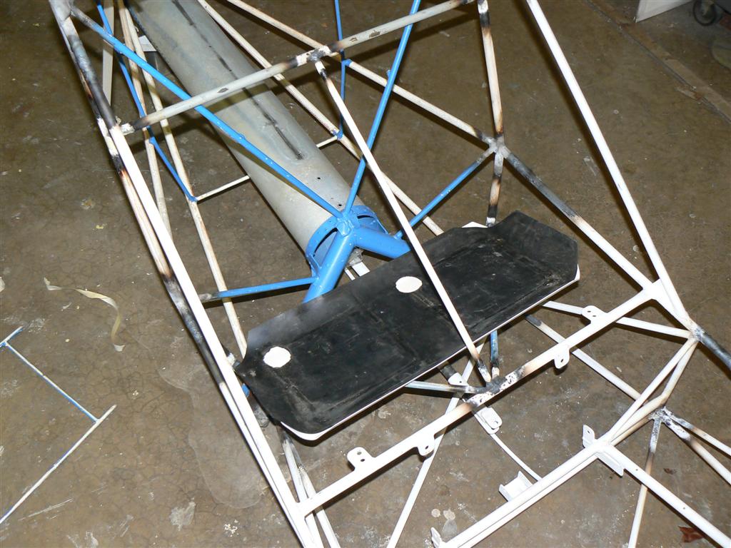

The 2nd picture is a FSII cage being being modded to put both tanks where the 2nd seat normally goes: you can see where the back of the PIC's seat is, and the tray that is in there is the stock factory issued gas tank tray for the FSII, and holds two 5 gallon tanks.
By measuring the size of a standard 5 gallon Kolb-style fuel tank you can pretty closely estimate how much distance there is between the back of the seat of the PIC and the structure that the passenger's back has to be up against.
By looking at these pictures and comparing them to your cage you should be able to tell if your cage is suitable or not.

Richard:
My frame/cage is very close to your first unmodded picture
with the gas tank platform in back. Without a doubt there is
a location for a passenger. Could the factory option for 2nd seat
be the seven rib wing instead of the five?
Thanks for the very nice pictures & advice.
