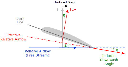

I have thought about the CoG problem. It is a range that the plane will operate throughout. But when the plane is in the air, the center of lift of a wing is 25%. I think that is the point that the plane rotates about when flying, not the CoG. When you raise or lower the tail you are changing the angle of attack of the wing by rotating the plane around the angle of lift. It becomes apparent that raising the tail reduces the angle of attack which also reduces the amount of lift. In my opinion, when the CoGravity is away from the CoLift you trim for the difference. The CoG will change, that is why it is a range, but the CoLift of your wing is always 25%. The easiest way to change CoG is to move the battery but moving the engine seems like it would have a larger effect although I haven't tried it. Has anyone else? An engine weighs more than a battery but the battery can have a larger moment and I'm too lazy to figure it out.
On a taildragger, we normally let the plane slow down until it quits flying. But when I see the contests to shorten the landing distance, it appears they are increasing the angle of attack above 19 degrees to the relative wind at which point the wing will stall at any speed. It should drop the plane out of the sky and then you overcome the forward inertia. The slower you can fly with the boundary layer attached to the top of the wing, the less forward inertia you have to overcome on ground contact. It's more of a bombing run than a landing in the contests, but a lot of people can't fly a taildragger because you can't flair and they are not very patient. In the contests they FLAIR.
A helicopter doesn't lose lift because the wing is rotating and producing lift all the way to the ground with no forward motion of the fuselage. The fuselage is just drag but raising or lowering the tail will change the area exposed to the stationary air along with the AoA. If we put a Kolb in a wind tunnel we could play with the elevator angle to personalize it, but I'll bet Homer wanted that wing at a certain angle of attack so he wouldn't get sued. But with an Experimental, let's have fun.
[img]cid:ii_jll1ini60[/img]

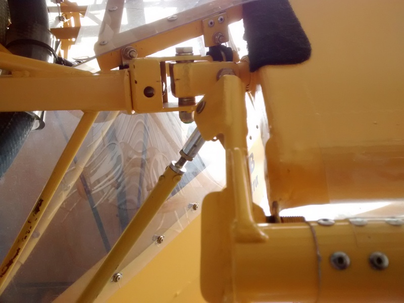

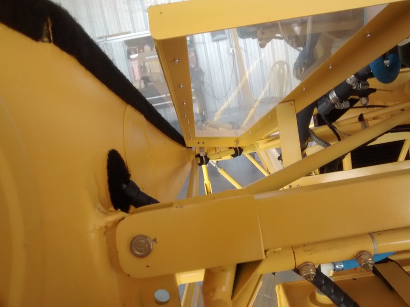

You said "Did you all know that no numbers are required, in most cases, if a Kolb is built to plans".
Mine didn't work out that way. I initally set the wings per measurement per the plans. At final assembly I called Brian for the angles as there had been a lot of discussion on the list at that time regarding wing angles. I had to redrill the front wing attachment and use the "reverse" back u-joint with washers to get the correct angles. (see pictures) The plane has flown great so I'm sure the angles are good.
Maybe I screwed up the measurements the first time? Don't know.
My point is that if you measure the angles you know exactly what you have.
 Filesize:  117.12 KB
 Viewed:  25070 Time(s)
 Filesize:  118.02 KB
